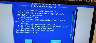

The USB-drive is seen as a valid storage device to install GAIA on. Whenever I remove the USB-drive and let it index for drives to only continue with the intended drive, then I receive a handful of errors that result in the immediate termination of the installation process. Pictures related.

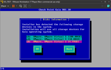

It doesn't appear possible to me to naturally deselect the USB-drive. The installation proceeded without error if I let the USB-drive become part of the filesystem as /sdb.

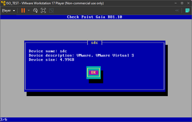

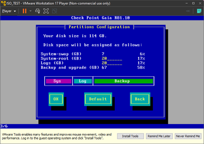

From my own lab environment, I am unable to find out how to deselect a drive, and they appear to form a raid:0 during the start of the installation. Lab pictures related.
This would explain why the installation of the SMS on the OpenServer is now unstable without the USB-drive with errors such as infinite loading CPUSE and session termination upon clicking the network management tab within the WebUI.
