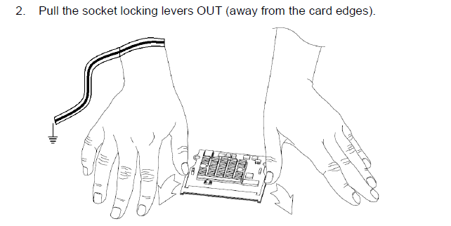

also when attaching that band to my wrist do you know where do i have to attach that band to for grounding as is shown in the images?
If I recall correctly, attaching it to the metal case of the appliance is sufficient.

Connect to the Ground contacts of e.g. the power strip on your desk.
