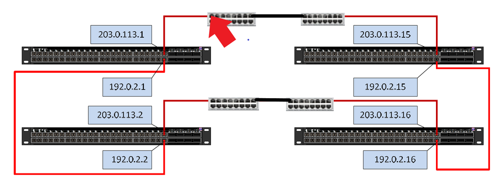

WATCH NOWCheck Point support L2 connectivity via switches for dual side integration, however, it must support Q-in-Q as well.
Latency requirement is <100ms and <5% loss.

Heiko, AFAIK the 192.0.2.0/24 representative SGM internal vlan without affecting you existing network. this is network between your MHO and SGM downlinks.
maybe other Maestro users know more about this

It is not a question about a down link but about an "inter-side-sync" link over a switch from datacenter 1 to datacenter 2.
I believe the Cisco config is missing the QinQ and LLDP tunnelling, should be something like below:
Interface EthX/Y
switchport access vlan xyz
switchport mode dot1q-tunnel
l2protocol tunnel all (or you can limit to the appropriate ones for you).
Not sure if the 192.0.2.0/24 addresses are changeable but not supposed to participate in any routing outside the MHO...
