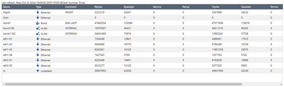

Thanks a lot Andy, what really drives me confused here is that my layer 3 interfaces which are vlan interfaces in fact has no errors whatsoever only the physical once and the bond have contantly the errors ...

Wait...what you sent shows zero errors on bond interfaces. Is this from today?
Anndy
it is from the time of my post mate !

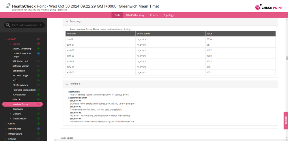

only LACP bond shows errors plus Physical line card eth1 & eth2 subs shows them too

eth1-01 Link encap:Ethernet HWaddr 00:1C:7F:69:35:BC
UP BROADCAST RUNNING SLAVE MULTICAST MTU:9216 Metric:1
RX packets:28025672 errors:1026 dropped:0 overruns:0 frame:0
TX packets:50260057 errors:0 dropped:0 overruns:0 carrier:0
collisions:0 txqueuelen:1000
RX bytes:21604026930 (20.1 GiB) TX bytes:27115248171 (25.2 GiB)
eth1-02 Link encap:Ethernet HWaddr 00:1C:7F:69:35:BC
RX packets:58247965 errors:1056 dropped:0 overruns:0 frame:0
TX packets:29294958 errors:0 dropped:0 overruns:0 carrier:0
RX bytes:40554860916 (37.7 GiB) TX bytes:24577395863 (22.8 GiB)
eth1-03 Link encap:Ethernet HWaddr 00:1C:7F:69:35:BC
RX packets:41292747 errors:985 dropped:0 overruns:0 frame:0
TX packets:32571941 errors:0 dropped:0 overruns:0 carrier:0
RX bytes:38834661276 (36.1 GiB) TX bytes:24399133125 (22.7 GiB)
eth1-04 Link encap:Ethernet HWaddr 00:1C:7F:69:35:BC
RX packets:31904176 errors:1127 dropped:0 overruns:0 frame:0
TX packets:40098582 errors:0 dropped:0 overruns:0 carrier:0
RX bytes:25592005559 (23.8 GiB) TX bytes:38347740796 (35.7 GiB)
eth2-01 Link encap:Ethernet HWaddr 00:1C:7F:69:35:BC
RX packets:34940552 errors:960 dropped:0 overruns:0 frame:0
TX packets:24319101 errors:0 dropped:0 overruns:0 carrier:0
RX bytes:30260935093 (28.1 GiB) TX bytes:19319642529 (17.9 GiB)
eth2-02 Link encap:Ethernet HWaddr 00:1C:7F:69:35:BC
RX packets:32174494 errors:789 dropped:0 overruns:0 frame:0
TX packets:49503751 errors:0 dropped:0 overruns:0 carrier:0
RX bytes:28595431480 (26.6 GiB) TX bytes:47316927330 (44.0 GiB)

hi mate, so I've did dig a little bit within the past week and found that driver which supposed to support that line card:
Line card 1 model: CPAC-4-10F-B
Line card 1 type: 4 ports 10GbE SFP+ Rev 2.0
driver: ixgbe
version: 5.15.2 (V1.0.1_ckp)
firmware-version: 0x800000cb
Apparently Gaia R82 is failing this particular driver which runs this NIC/LINE CARD.
