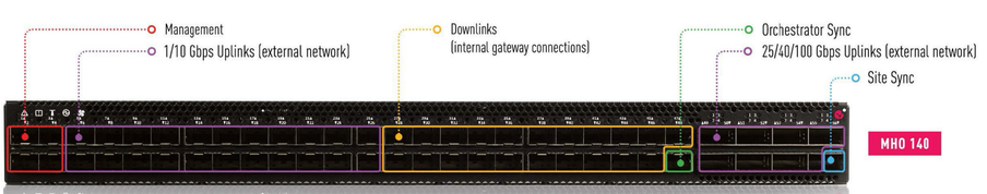

Understanding Maestro (MHO) Ports
Uplink Ports
Downlink Ports
Used for internal communication between the orchestrator and the firewall modules.
The image below shows the downlink connection between the Maestro and the SGM and the sync port connection between the MHO-140 appliances

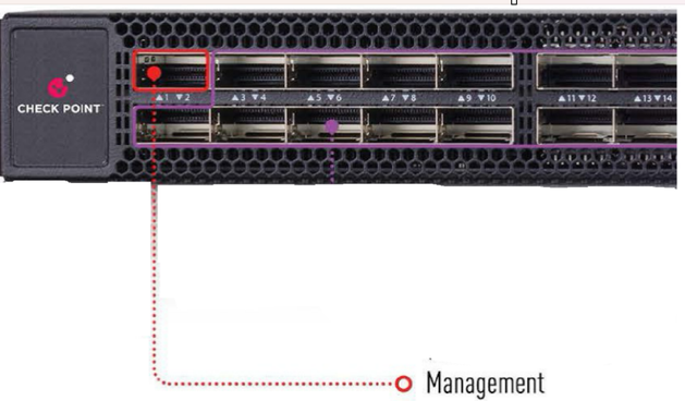

Management Ports
The image below shows Management SG port, located on the front Panel of the MHO-140
The image below shows Management SG port, located on the front Panel of the MHO-175
