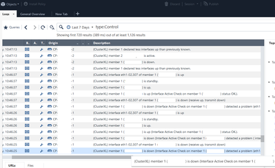

We have two 5800 gateways (naming them CP1 and CP2) in a High Availability cluster. Current version is R80.20. At November 11 at 10:46:25 we experienced an unexpected failover from master CP1 to stand-by cluster member CP2. According to the cluster log the failover reason is cluster interface eth1-02.307 CCP down at 10:46:25 so our CP1 cluster status went DOWN. One second later our cluster interface eth1-02.307 has recovered so CP1 cluster status went from DOWN - - > STANDBY.

Here is the output from our SmartConsole log section where we filtered type:Control, so you can see cluster failover log:
