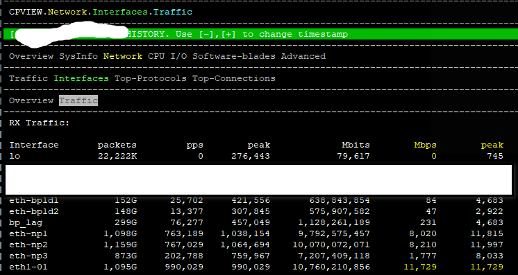

Hi Team,
We come across to know that one interface is highly utilized.
Setup: 21400 Appliance with SAM Hardware (R80.10 OS)
4 SND and 8 Fw worker
Only FW , Identity Awareness and Monitor Blade Enable.
INTERFACE : 10G
Interface 10GInterface 10G
Utilization taken from CPVIEW (eth1-01 utilized more)
eth1-01 interface highly utiizedeth1-01 interface highly utiized
NO RX Over
We can see the interface is highly utilized but NO Rx Over .
Kindly suggested a solution for this

Please provide the output of ethtool -S eth1-01 for further analysis.
That interface seems to be handling the load just fine with negligible RX-DRPs and no other errors, what is your specific concern?
Is that eth1-01 interface part of a bond and the traffic is not being distributed evenly between the physical interfaces of that bond of which eth1-01 is a part?  Can't really tell from what you have provided so far.
