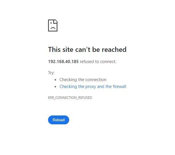

But when try to open https://192.168.40.185, I get this:
Can you send output of ifconfig -a and route?

Its from expert mode, ifconfig works fine, as well as route command. Anyway, what you sent is sort of same...so if that interface is up, can you check if same happens if you try another browser? Make sure if fw is not connected to mgmt, its most likely running initial policy, which WILL block web UI access, though since its port 443, technically it should work, but as a test, you can run fw unloadlocal from expert mode and try again.
Tried all browsers: Firefox, chrome, and Edge. Same problem!

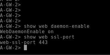

Ok, so its just mgmt server, got it now. Maybe as a quick test, disable web access, save, re-enable, save, test again.
if you mean:
set web daemon-enable off/on
that did not make it better!

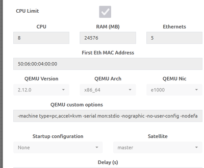

my eve-ng fw settings
Since you’re installing this in EVE-NG which is not technically supported, what specific ram/hdd did you allocate to the VM?
What version was installed?
If you did not allocate the minimum values specified in the release notes for the version you’re running, you could experience behavior like this.
Realistically for a standalone gateway in a lab (no external management), you need to allocate at least 8GB of RAM and about ~200GB for hard drive.
That is assuming lab usage only.
My machine got 4 vCPU and 8GB ram and about 40GB disk.
The same specification (maybe less) is working when running the server directly on VMware workstation!
I run 81.20
I use eve-ng all the time and I never give it more than 100GB, works just fine.

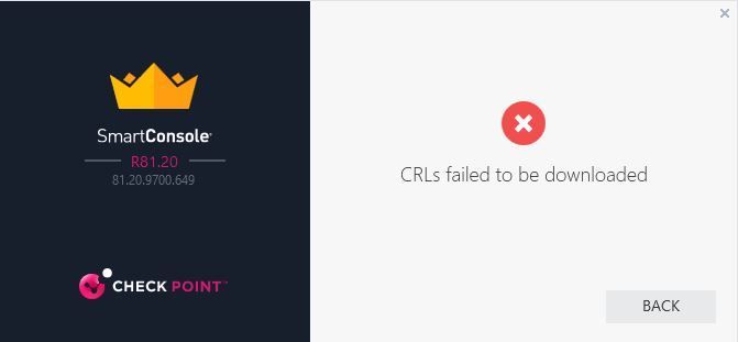

I have now configured one server as SMS using (config_system). When trying to connect via SmartConsole I get this:

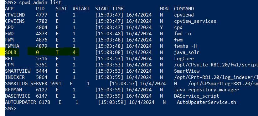

SOLR service is restarting all the time:

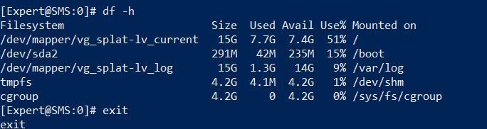

Disk space on this SMS:
Any ideas!
Hey bro,
I dont think space would be an issue for this specific problem, as I was able to log in fine to my old mgmt in eve ng with less than 6 GB free in root dir. Now, here is what I would do. First off, run api status command, see what it shows. Im fairly sure it will show failing at the bottom, if it does, please do this.

maybe the problem is with the SOLR service which does not start !
