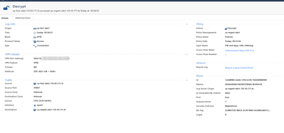

So far so good. I am able to manage the gateway, retrieve its topology, push policy and the gateway is even sending logs back to the SMS. I'm now attempting to access the gateway remotely from home via Checkpoint ENDPOINT VPN. It is connecting but failing on "Failure to retrieve CRL". I have narrowed it down to FW1_ICA_Services and I can see on every attempt the gateway attempts to reach the gateway, but the log entry certaintly shows its being picked up by Implied Rules:
As opposed to something like CPD or CPMI currently leveraging the VPN tunnel:
This KB kindly lists the VPN services required:
Great I thought, I must have forgotten to disable something from implied_rules.def. I close down SmartConsole as per the kb, but I already have fw1_ica_services disabled. I made sure to push policy again (to both gateways), but implied_rules are still picking it up. Here's what my implied_rules.def looks like right now:

Thanks.
Both are 81.10, built off the same ISO even.
I think I see why its happening:
In between the gateway in question and its mgmt server is ANOTHER gateway performing a route based VPN. In other words, the gateway I'm managing remotely isn't the one terminating the Site2Site VPN.
(If you're curious, what I'm doing is bringing in Site B's cluster members into the management plane of Site A, without losing access to Site B. 1 Gateway/Firewall at a time that grabs a secondary WAN IP as I move it. Site2Site remains up to leftover gateway at Site B as I configure the gateway I pull out of Site Bs management plane. Once I'm happy with the policy and that I can access Site B over secondary IP but managed by Site A; I do the remaining gateway. What I'm really doing is mimicking the layer 2 interconnect I'll have in many... many weeks because I'm inpatient and want everything ready) ......anyhow:
What appears is happening is the gateway handling the Site2Site Route Based VPN in between the gateway I'm accessing and the SMS is "choosing" to perform NAT on FW1_ica_services and translating the source to its local VPN-Tunnel Endpoint. Its not doing this with any of the other interesting Checkpoint MGMT traffic (such as CPD).
The other side then rejects this like so:
I just tried making a NO NAT rule as well as making sure this intermediate gateway (the one doing the NAT to its VPN Tunnel endpoint) has the implied_rules.def modification, but its still happening like this.
