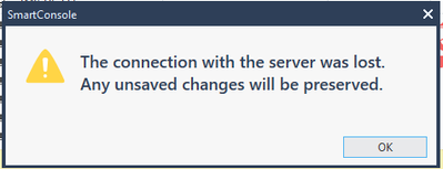

SmartConsole Crashes when POLICY is installed
facing connectivity issues between  Checkpoint Smart console and the Management server.
After restarting the FWM services, able to notice slow connectivity
Attaching error screenshot
Server-r80.20
SC-r80.20

Hi
This might happen if the Install Policy cuts the connection between the SmartConsole and Security Management Server. Check the following;
  • If there were changes in implied rules that might effect this
  • If Anti-spoofing logs are generated for the SmartConsole connection that is dropped
