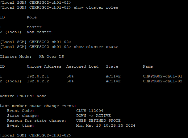

How can I know what SGM IDs and what Member ID to type in the commands? I am new on Maestro, I can see this:
Are these the members IDs? And the SGM IDs? What commands can I use to know them?

Yep, those are members IDs.

I believe the format is {chassis_id}_{member_id}
'asg monitor' command will give you a better picture.
it appears you have two blades in 1 chassis, 1_1 and 1_2
it looks like you have 2 different clusters in that GUI monitor window, though, maybe multiple sites?  as the blades don't show up separately in the GUI, you should just see a single management object for each maestro cluster afaik
