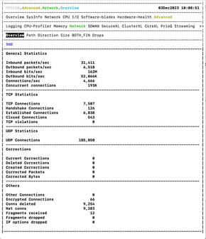

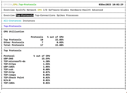

Hi Guys,
i'm not sure if this is normal or not. but as of today we are troubleshooting one of our customer firewall and we notice that UDP DNS is taking up most of the CPU processing and from almost 200K+- concurrent connections 180K+ is being used by UDP. Looking for some comment and suggestion from all the masters. We are currently doing some checking on what is causing the memory to utilize almost 70%. the appliance is using 6700 with 32GB of RAM installed inside the appliance.

Basically, we just upgrade the firewall from R81.10 to R81.20. Previously when using R81.10. the firewall memory are only utilizing around 60% and went down when the traffic is low. However, after upgrade to R81.20 we notice that the firewall memory being utilize up to 90%+ and most of the time cause traffic drop. and i notice that UDP traffic is taking most of the utilizations. that is why i'm asking if it is normal to see UDP traffic that high.

Yes, we do have that. currently we enable firewall and mobile access. we plan to enable IPS but since the memory is not stable we disable it first.
i will try and see if your suggestion works for my environment.
thanks @Chris_Atkinson
Recommend also restricting the rules allowing DNS traffic so it is less broad in that case.
I assume that there is an internal DNS server that users should be querying rather than external/public.
hi @Chris_Atkinson ,
i follow the tip 7 just now and can see concurrent connection drop from 180K to 80K. cpu utilization also coming down now. still monitoring the situation first. yes, our customer do have internal DNS server to query outside. but they also allow internal to query specific external DNS server. just not sure why during using R81.10 this issue does not arise. Only see this when upgrade to R81.20.
