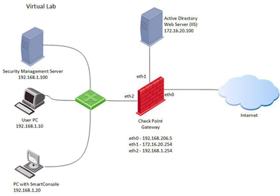

In this part, we will discuss different types of Network Address Translation (NAT), set up Internet access for our lab, and review a common example of Port Forwarding.

Unless I am missing something the Manual NAT rule in the last example here cannot work unless a proxy ARP is configured.
The steps and description for that seems to be missing from this page/lab.
Makes me wonder what was configured to get the last screenshot.
Regards,
Don
Timothy_Hall
MVP Platinum
MVP Platinum
A manual Proxy ARP is not necessary in this case since port forwarding of http to the DMZ server is being accomplished using the firewall's existing external interface IP 192.168.206.5.  The firewall will already answer ARP requests for that IP address from the Internet perimeter router.  If the manual NAT example was using another IP address plucked from the subnet located between the firewall and the perimeter router (such as 192.168.206.155 assuming a /24 mask) then yes a manual static proxy ARP would be needed.

Now the question is, is this the best NAT scenario for this course?
I've seen and done many types of NAT. Funky stuff and standard stuff and i am thinking that maybe the more common NAT scenario is better here, where a dedicated IP address is used. Or two.
And then manual and automatic destination/static NAT rules can be covered.
Doesn't Check Point generally recommend automatic NAT rules?
Thanks,
Don
_Val_
In this specific case, automatic static NAT would work too, and probably could be a more reasonable option. However, this is just an example of what's possible, and considering the fact manual NAT takes a bit more effort to set, is a good educational decision 🙂
