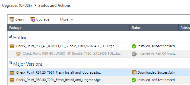

Hi,
Can I upgrade MGNT & Gateways directly from R80.40 to R81.20? on both of our management and Gateway after verify the packages under CPUSE it said Update allow. After verify it can be done, I will upgrade MGNT and latest Smart Console  first because it can support Gateway with lower version, then planning to upgrade our cluster GW.

Yes, you can jump from R80.40 straight to R81.20. Earlier versions should stop off at R80.40 first.
Yes, you should upgrade the management first. Once you have the management upgraded, you should take a look at CDT in SmartConsole. It can upgrade your firewalls from the management server. Great feature.

As @Bob_Zimmerman said, yes, you can. Below is link to do proper verification.
