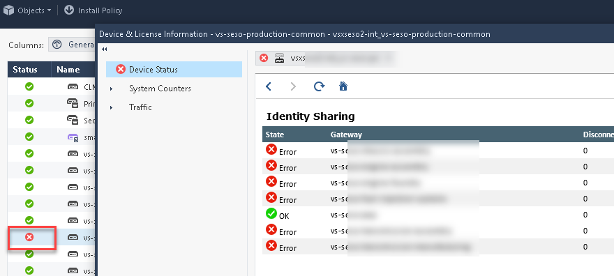

Have a peculiar problem after introducing Virtual Router on our VSX to interconnect most VSes on that cluster.
If traffic originates from a VS on the standby VSX and it needs to reach another VS (i.e. Identity Sharing on port 15105) or a service that's behind another VS (i.e. DNS for FQDN objects), it will stop dead in it's tracks at the standby VR - I'm assuming VR is not forwarding traffic as it is in standby state. Diagram below might help understanding the issue:

as well as standby VS that's publishing IDs to other VSes is marked as "failed" in SmartConsole:
