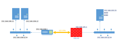

we have one Security Gateway R80.40 with S2S VPN configured as shown on the picture:
we initiate a connection in a browser for the server 192.168.108.21 (left side) to the server 192.168.105.55 (right side) - it works.
then we initiate a connection in a browser for the server 192.168.108.22 (left side) to the server 192.168.105.55 (right side) - it doesn't work. TCPDUMP shows TCP Retramsmittion - the server 192.168.105.55 constantly answers to the source server, but the answer does't reach destination. It looks like the traffic was not sent to the S2S Tunnel:

And now most intresting thing: when we initiate a connection in the PowerShell using Telnet or TNC command, or ping - it works:

Before I open Support Case, maybe someone on the forum can help me in this question: Why connection works from one server, but from another it doesn't even if the Ports are open?
Thank you in advance!
the problem was on the remote side: the server was sending data to the default router, which forwared (routed) to another router on the same network. As soon as the remote side configured a static route (avoiding the default route) for the target network on the server, the problem disappeared.
Are the left side servers running the same OS?
Could potentially be an MTU issue requiring MSS clamping.
they have the same OS Windows Server and same MTU
