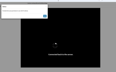

I am trying to perform a fresh install for a remote gateways 9200 (LOM version 7.12.1) and for qls250 (LOM version 6.22) via upload cd images (different images for 9200 and for qls 250)from my computer in LOM console session.
Problem:
The speed is only 1 KB per couple of minutes.
Sometimes after waiting 15-20 minutes, 4-5 KB is uploaded and after that the session in the console is interrupted,the file upload progress is reset and everything starts over.

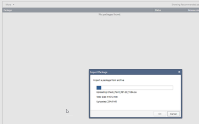

The firmware for LOM (60 MB) is uploaded in a couple of seconds. I also checked the upload of the same iso file for the same gateway to cpuse (Mgmt and LOM interface in the same network) via the "Import package" (it doesn't make sense, but it provides visual information about the upload speed) - it takes a couple of minutes to upload the iso file (4 GB).
Therefore, I concluded that there are no network problems, the problem is in the LOM settings.
