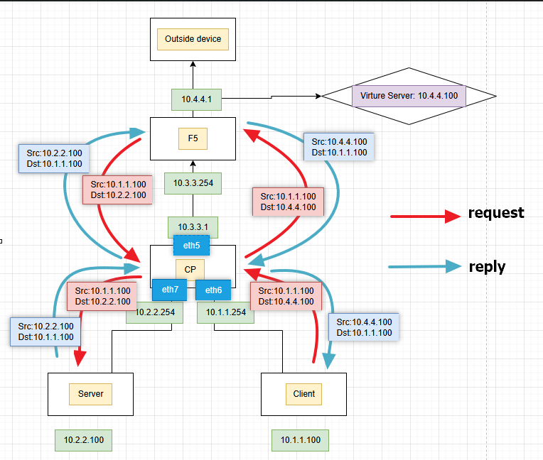

Both the Client and Server are on directly connected networks of the Gateway. When the Client accesses an internal Server service via the Load Balancer (F5)'s virtual server IP, and without configuring S-NAT on F5 or PBR on the Gateway, how can we make the reply packet (blue line) return to the F5?
A simulated architecture diagram is shown below.
update:
After discussions between the CP team and the customer, the customer’s goal is to ensure that reply packets exit through the same interface the request packets entered from.
I’ve updated the interface port numbers in the network diagram:
Is there a configuration method that can achieve this behavior?

ElasticXL (in R82) might actually handle this with the CCL (when the other gateway receives traffic and it's not the primary, it's forwarded to the primary).
Otherwise, what you're asking for is likely an RFE and the solution in the meantime is, in fact, using SNAT.

It appears that FortiGate prioritizes routing reply packets based on the session table, rather than strictly following the routing table. I believe this is the behavior the customer is aiming for, which is why they want to confirm whether Check Point can achieve the same functionality.
I am sorry, what is the exact challenge here? If routing is configured properly, it should work out of the box, shouldn't it? What do I miss?
Hi Val
Based on the network diagram I provided, the customer wants to achieve symmetrical routing (same path for request and reply) without configuring S-NAT on the F5 and without setting PBR on the Gateway.
Can Check Point route reply packets based on the session table, rather than strictly relying on the routing table, to achieve this behavior?
I dont see why not...thats how whole concept of stateful inspection is designed to work.
Not exactly.
I suspect if it's possible at all it would be a secureXL kernel parameter, might be a topic for TAC / RFE.

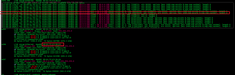

Since the source IP remains unchanged throughout the entire request path from the Client, when the Server sends the reply packet back to the Gateway, the Gateway routes it directly to the Client based on the routing table.
If the packet is not returned to the F5, the F5 will drop the entire connection because it does not receive the ACK packet.
You can refer to the tcpdump I captured in the lab for more details.

Ooookay, I see it now.
This is a weird topology. Why do you need to FW traffic to F5 twice, on both server and client side? It would only be reasonable to set F5 and the servers in the same segment.
Hi Val
In the customer's architecture, if the Client wants to access the Server's service, it must do so via the F5's virtual server IP (used for load balancing).
There’s no issue when the Client is located on the outside of the F5, but as shown in the architecture diagram, if the Client is on the inside, it cannot access the service properly.
