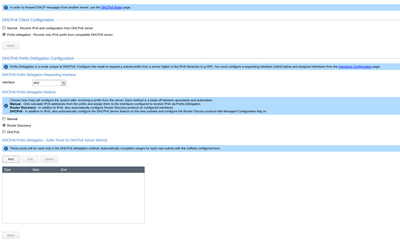

I've been trying to get IPv6 running with prefix delegation in my testlab for a few days now. I have configured my router (AVM Fritz!Box) so that it distributes a prefix via DHCPv6 (assign prefix (IA_PD) and IPv6 address (IA_NA)).
On the Checkpoint 3600 (R82 JHT19) I have activated IPv6 and configured the options as I consider them necessary for prefix delegation.
Unfortunately, no IPv6 address arrives on the interfaces and I cannot find any DHCPv6 packets in a tcpdump either.

No, DHCPv6 Server is disabled. I only need DHCPv6 Client and behind the checkpoint SLAAC and IPv6-RA.

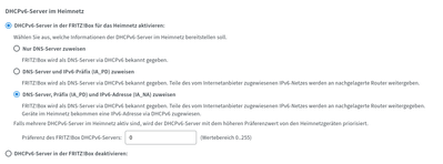

Prefix delegation won't work if higher router send IA_NA, only IA_PD seems to be supported.
Not sure you can influence this on your Fritzbox, but it helps to set:
Minimum RA interval = 200
Maximum RA interval = 600
Lifetime = 7200
The router needs to advertise a prefix larger than /64, e.g. /62, /60, /56 etc.
Your parent interface needs to have NO ipv6 address (no autoconfig, not anything else).
Your child interface needs to have "obtain via prefix delegation).
Policy needs to permit protocols required on child and upstream interfaces / zones.
dhclient would write log to /var/log/messages which you can access via syslog / expert mode.

Ok, thanks for your hints. I did set the Router now on IA_PD only. An /57 prefix should be advertised by the router.

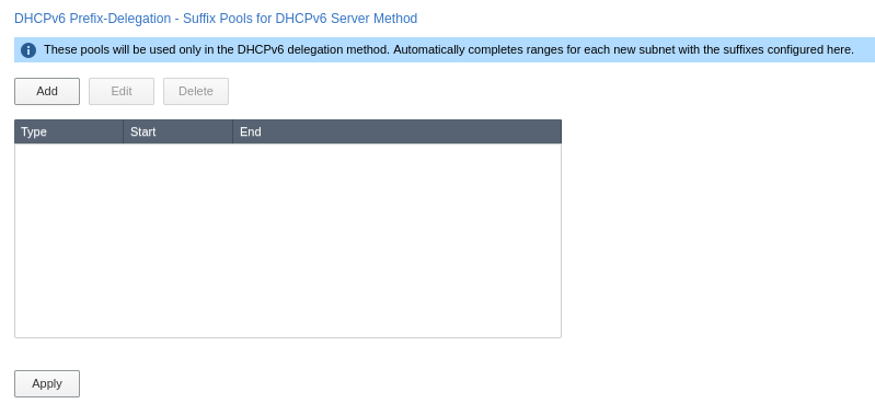

Should these suffix pools be filled?
Once received, your DHCPv6 Server Subnet Configuration will get populated automatically (so will the IPv6 address on the child interface), see screenshot (DHCPv6 in this context does not mean you will be sending the M-flag). Sending O or M flags is configured under IPv6 Router Discovery (second screenshot).
I can spot a minor difference of your dump compared to mine: my router is sending both A and O flags, yours is sending just A flag. If you are distributing RDNS, you should be sending O-flag too (third screenshot).
It's a bit better now. It looks like the checkpoint now requests a prefix, but only a /62 which is not big enough.

Is it possible to define somewhere what size the requstet prefix should have? And how the individual nets are distributed to the interfaces?
Regards, Jochen
/62 contains 4 /64 prefixes, are you trying to hand out more?
With prefixes smaller than /64 SLAAC won't work in many cases.
R82 uses DHCP Client 4.2.5. The "right" way would adding the --prefix-len-hint parameter to the command line
/sbin/dhclient6 -6 -P -d -lf /var/lib/dhclient/dhclient6_pd.lease [parent interface]
but I do not know where the dhclient6 is started from, and whether the parameters can be changed. I'd love to find out, though. There are many parameters, which one could need to change, like -N to request IA_NA with IA_PD to avoid the problem with HTTPS inspection I reported a while ago.
Yes, a /62 is enough for 4 child interfaces. But unfortunately the checkpoint tries to assign the same IPv6-Address to every child interface, which isn't working. It would be great if there would be an option to assign a "subnetid" or something like this to every child interface.
How can IPv6 routing work with this option, when the parent/outbound interface has no IPv6 address. So there is no IPv6 default route and ipv6-routing is not working.
@oa_munich wrote:R82 uses DHCP Client 4.2.5. The "right" way would adding the --prefix-len-hint parameter to the command line
With a short grep I didn't find any dhclient configuration in the configuration directories.
Link-local addresses are used as gateway IPs in IPv6, not public addresses. It is not a requirement to have a public ipv6 address on your parent connection.
Not having one on the parent interface does raise a strange downside. When HTTPS inspection is used, a probe performs its connection initiating from the parent interface - which has only a link-local address. Here's a lengthier thread on this. The consensus was to NAT66 the link-local ipv6 address of the gateway by the parent router. I do not consider this a valid solution myself, but it works as a workaround.
There is a /etc/dhclient6.conf file.
@oa_munich wrote:Link-local addresses are used as gateway IPs in IPv6, not public addresses. It is not a requirement to have a public ipv6 address on your parent connection.
Yes, but how can I set them in Checkpoint IPv6 Static Default route. I can only set an address or an interface.
The config file I have to check, when I'm at home.
Your clients will have the default route to your gateway already. Am I understanding correctly that your Fritzbox is not advertising ::/0 route and the gateway does not have it as its default gateway? Can you share the screenshot of your Routing Monitor?
If this isn't happening, you can set the default gateway manually and point it to the link local address of the router.
