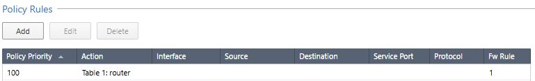

2) PBR was configured to be Application Aware (it's a shame that this is hidden by default) - so I can create a rule in PBR that will tell gateway that it should match rule 1:
 3) Table 1: router forward traffic to different router (in my case 10.99.99.203)
So ... as you can see ... nothing odd, just a normal, simple PBR config.

What's this minor change ?
I just added additinal matching criteria to my PBR rule ...
SG> set pbr rule priority 100 match from 10.20.200.0/24
SG> show pbr rule 100
PBR rule 100 from 10.20.200.0/24 fwrule 1 table 1
SG> save config
And by accident ...it solved this issue !

@marcyn I replicated this and its exact same issue as you. I tested on R82 jumbo 41 (latest) one. Now its good challenge to fix it : - )
Best,
the_rock
MVP Platinum
MVP Platinum
@marcyn
Here is how I fixed it
Enabled this kernel parameter -> fw ctl set int fw_allow_asymmetric_routing 1

One minor change in configuration for PBR rule ... .and now it looks like this:
[vs_0][fw_0] eth0:i[44]: 8.8.4.4 -> 10.99.99.234 (ICMP) len=84 id=0
ICMP: type=0 code=0 echo reply id=10003 seq=1
[vs_0][fw_0] eth0:I[44]: 8.8.4.4 -> 10.20.200.222 (ICMP) len=84 id=0
ICMP: type=0 code=0 echo reply id=51307 seq=1
[vs_0][fw_0] eth2:o[44]: 8.8.4.4 -> 10.20.200.222 (ICMP) len=84 id=0
[vs_0][fw_0] eth2:O[44]: 8.8.4.4 -> 10.20.200.222 (ICMP) len=84 id=0
Perfect ! we have routing to eth2 !
SG> save config
