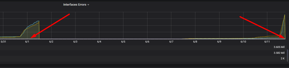

[4] Graphs show steady increase in interface errors before the issue happens
[5] Graphs show constant increase in F2F packets and at some time the issue happens

Steady interface error increase before the issue (maybe because the CPU is handling packets and it is at 100% so it discards erratically)

2) When you say interface errors I assume you mean RX-DRP events?  Technically that is not an interface error but is usually just a side effect of overloaded SNDs.  If it is indeed RX-OVR or RX-ERR you need to get that fixed immediately.
