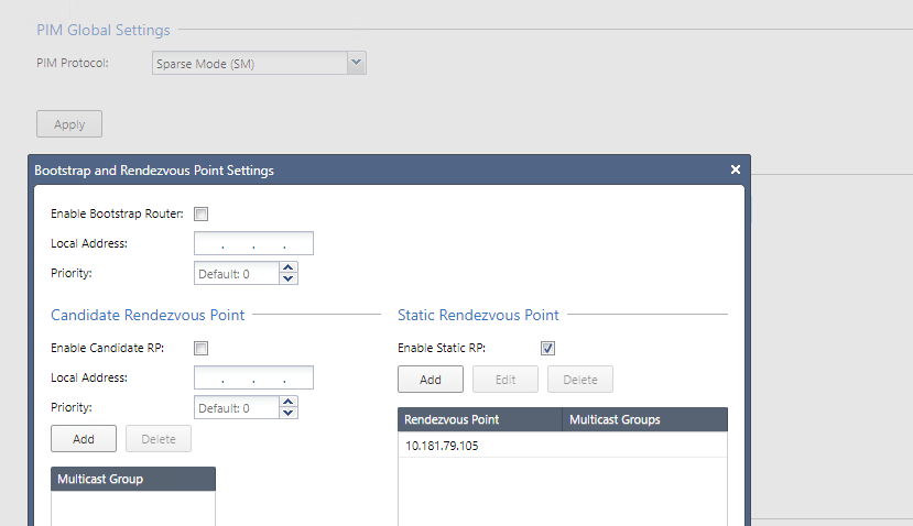

We're having a very odd situation here, we have Multicast working fine with Cisco ASA having an Cisco 6509 as a RP, and we're migrating this ASA to SG6200 running R81.20. We migrated one VLAN and can see Multicast working fine, except for the fact that the multicast stream is stop to work (like freezing for around 10 seconds) every 60 seconds. So we have it working for 1 minute, then we can't receive the multicast traffic on the end host for 10 seconds, then back to work again automagically. I've tried to play around with the Multicast timers, no lucky. At this point we have the timer in their default values. The only configuration we have for Multicast is setting the RP static, using PIM Sparse Mode.

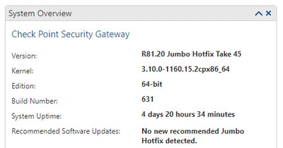

I saw many HF to be applied for the old versions but as we running R81.20 there is no HF for this version. Anyone had experienced this issue?
We assume the all Multicast configuration is working fine as the multicast is working and we have all firewall rules in place, all multicast traffic is being allowed and we can't see anything being blocked. When we test the same machine in a VLAN behind ASA, we don't experience this behavior, the stream keep running smoothly.

Note for information there are additional multicast fixes in JHF T70, refer:
https://sc1.checkpoint.com/documents/Jumbo_HFA/R81.20/R81.20/Take_70.htm?tocpath=_____6
Not sure latest jumbo would help here, but you can certainly give it a go. Just curious, when did this start happening? Do you see any logs in smart console for 224.0.0.x?
