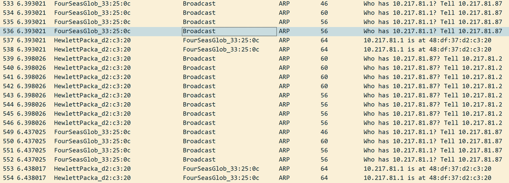

Recently we find an interesting thing, the environment is as below:
2x Gaia Security Gateways (R81.20 take 26 ) in a ClusterXL Active/Standby mode, the VIP is 10.217.81.1, the active member is 10.217.81.2 .
The interface acted as a gateway of wifi users, the DHCP is on the Wifi access switches. As the DHCP will change the ARP entry and according to sk175603 https://support.checkpoint.com/results/sk/sk175603 , the parameter was set to 1 ( fw ctl set int cphwd_refresh_nh 1 -a )
Let's see the below captures, we can see that from Frame No.533 to 536, the client 33:35:0c keeps asking gateway's MAC.
At Frame No.537, the gateway d2:c3:20 replied to the client.
My question is, why the Gaia gateway didn't learn the ARP entry for the client 10.217.81.87 from Frame No.536?
And from Frame No.539, the gateway 10.217.81.1 keeps asking for the client's MAC, which should tell to 10.217.81.2 ? This behavior really looks like an ARP Spoofing... and if downstream switch turned on Anti ARP Spoofing feature, these broadcasts might be taken as spoofing.. (e.g. A asks for B's MAc address and tell to Z ?....If A asks CDEFGHIJKLM's MACs and all send to Z , then Z will receive huge replies from CDEFGHIJKLM..)
Actually this is our issue : the client didn't receive these ARP request broadcast packets, and the gateway doesn't have the ARP entry for the client 10.217.81.87. So if a Frame reached Gaia gateway, but it doesn't have the destination MAC address, then the Frame will be dropped?
Any ideas about the ARP learning process of Gaia Gateway, I know it is Linux OS based, and might totally different with Cisco Switches...I think Cisco Switch should be able to learn the ARP entry from the ARP requests which sent to gateway.
Thanks very much.

i assume this packet capture was taken on the GW, please let me know if it's not the case.
1. it's possible that passive arp learning is not enabled on GAIA.
2. when working with cluster HA, the same MAC address of the active GW is used for both the physical IP and the VIP.
2.a - when the member is reaching out to get arp, it uses it's own physical IP as src IP, and it's MAC address.
2.b - i don't see why there should be mac spoofing, as this is how cluster is operates, as the mac shared between physical and vip ip addresses. and packets can be sent sometimes from vip and sometimes from physical IP with the same MAC.
from what you describe, it sounds like the issue is that BC arp request sent from the GW is not reaching the host (did you verify that with wireshark on the host?), and because of that the GW is not able to learn the arp of this host. so this what needs to be investigated, my guess would be on switch level.
"So if a Frame reached Gaia gateway, but it doesn't have the destination MAC address, then the Frame will be dropped?" - actually if you will look at the ethernet layer in this packet you will see that it has dst broadcast address, which the switch should send via all it's ports on the broadcast domain, and in case you took this packet capture on the GW, than the packet has reached the GW and didn't drop, and as you can see the GW even respond to that back to the HOST (is that reaching the HOST, is the host have the arp of the .1?)
in the ARP layer the dst MAC is empty because the host asking for the request still don't know the mac of it's dst.

so let's put things in order,
--- Actually, it is captured on the WLC ( which connected to GW directly and in the same VLAN) , we have captured on the GW as well, and got the same result
--- Could you please let me know to check and turn on the passive arp learning ? Then I might test if any help .
--- Yes, I checked the broadcast frame, it did sent with the active member's IP as source , but the same MAC with the VIP.
--- Yes, the BC arp request did reach WLC, but didn't reach the host, the below is the capture from HOST.
I noticed that there is only one broadcast ARP Announcement packet since the HOST got the DHCP IP, so I just doubt why the GW didn't learn the HOST MAC from it ( not sure if it reached the GW, because only one packet sent, and hard to capture it )
-- that is what I suspect. Because I did see that the DNS traffic and Web Authentication traffic from the HOST have already reached the DNS server and Web Authentication Server, but no return/reply traffic reached the HOST, so DNS and Web Authentication failed. I just suspect if the GW dropped the traffic, as the return/reply packets whose destination is the HOST's MAC will be dropped because of no ARP entry for them on the GW.
How can I check if those return/reply packets dropped or not by the GW?
Thanks again and much appreciate for your patient reply.
Best regards
George

Just throwing this out there...for proxy arp, once added, needs policy install. As far as regular arp, if its saying who-has, it definitely tells us that its not able to "discover" the device or host in question. Why? Thats another question. Have you tried doing zdebug to see if firewall is indeed dropping it?
Say if IP is 10.10.10.10, you can run fw ctl zdebug + drop | grep 10.10.10.10

I am thinking is it possible to let the GW send ARP request to the WLC directly, as the DHCP is on the WLC, so it should know all the IP-MAC entries for all hosts.
That is, GW send a unicast to WLC: "who has 10.217.81.87, please tell 10.217.81.2" , it would be another solution for the issue.

Not very sure whether the WLC dropped the broadcast packets or not, but if the GW can learn about the ARP entry from the ARP request then it will solve the issue.

well, you can add static arp entry in the OS to be 100% this is the issue.
If i were you, i would configure mirror port on the port connected to this PC, and get the output on another PC with wireshark. and see if the switch actually passing the arp broadcast to this PC from the GW to this port. if it doesn't, you need to figure out why, check the port configuration and stuff. and if it does, that means packet is dropped on the socket of the NIC or something like that, and that's another question. (but unlikely).
I'm not familiar with any official way to change the arp behavior in GAIA so it learns arp passively. but maybe there is..
but anyhow, it would be a workaround, and you still have some issue on your L2 network.

Thanks very much Amir, yes, when I add the static ARP entry, the issue was resolved, which means it is the ARP related issue.
Finally we upgraded the Wireless Controller firmware version,and solved the issue.
Not the firewall's fault but it is a good chance to learn more about the L2 mechanism on GAIA platform.
