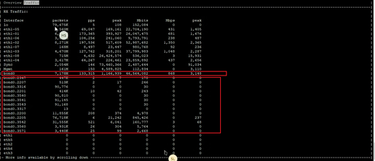

When I observe RX throughput in CPview, I saw an strange behaviour whereby bond0 has value around 800Mbps to 1000Mbps, but there is zero value for its all vlan subinterfaces.

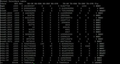

The output of netstat -ni shows there is RX packet in its bond0 subinterfaces.

Please confirm the appliance model and NIC type used?
When SecureXL works in the User Mode (UPPAK), traffic statistics on the Security Gateway do not contain packets and bytes for connections that are accelerated in hardware.
This applies to:
CPView > Network > Interfaces > Traffic.
Output of the "fwaccel stats -s" command.
Traffic statistics for the physical interface contains packets and bytes for connections that are accelerated in hardware for all VLAN interfaces configured on this physical interface.
Source: https://sc1.checkpoint.com/documents/Appliances/100G_Ports_AdminGuide/Content/Topics-100G-Card-AG/Kn...

The model is Quantum Force 9300 Security Gateway and the interface bond0 is at NIC CPAC-8-1/10F-D that connected with SFP+ transceiver 10GBASE-T RJ45 (Copper).
