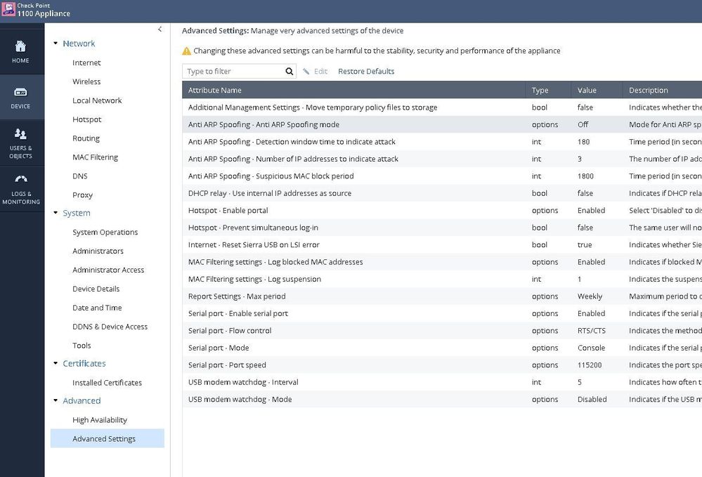

Hi Colleagues.
Help to understand what could be the problem?
So there is a device SMB 1100
Version: R77.20.80 (990172392)
The device is controlled centrally with SMS R81 GAIA.
On the device configured Bridge for two interfaces
LAN8 and DMZ.
LAN8 -> Windows PC
DMZ -> INT LAN GW R81 GAIA -> Internet.
Traffic walks perfectly through this Bridge, but does not work Application @ Url Filtering and HTTPS inspection.
There are no entries in logs on these two blades.

Per sk111756 / sk102296 how are the following advanced settings currently configured?
Note 1100 & R77.20.80 will be End of Support in Jun-2022 and you should consider upgrading for relevant feature enhancements such as sk123035 amongst others.

For sk102296
I turned on for dpi_lan_lan and dpi_lan_dmz
True
(the problem is not solved)
For sk111756
I did not find parameter Allow LAN-LAN DPI.

The sk102296 is for centrally managed SMBs like you have - Additional Settings from sk111756 do not apply here, only for locally managed SMBs! Did you do a policy install and are the new values viewable in DBedit ?

I would suggest to contact TAC - this did work in newer firmware versions as expected ! But i do not see why you are not using the WAN IF...
