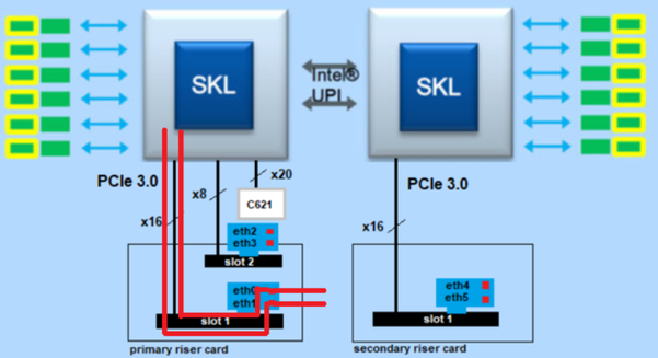

| Intel Skylake arcitecture on HP Server DL360/380 G10 |
The Skylake platform will be divided between three major categories 2S, 4S and 8S. HP DL 360 G10 server use the S2 architecture. In the following example we will look at an HP DL 360 G10. I don't want to get into the depths of architecture here. We just want to look at the PCIe bus. This point is very interesting for the use of 10 GBit cards.
All Intel processors of the series Intel Xeon Platinum 8xxx, Gold 6xxx/5xxx, Silver 4xxx and Bronze 3xxx have a 48 lane PCIe 3.0 arcitetur. Another interesting point to note is the fact that not only will update the number of PCIe slots to 48 but they will finally be configurable in x4, x8 and x16 divisions.
The onboard interface on the server is provided by an Intel chip set C621. This chip set is connected to processor one (of two). It is also used for other devices like USB 3.0/2.0, SATA, 4x1GbE and others. The problem here is that 20 PCIe lane‘s are used for this C621 chipset. So in extreme cases only 28 (48-20) lanes remain for the riser card.
The riser cards are connected to different CPU‘s. With the DL 360 G10 this is as follows (see table).

Here I see a small disadvantage with the construction of the HP servers. CPU one is responsible for the C621 chip set and provides a riser card for 2 slots (x16, x8) at the same time. Therefore only one slot with x8 remains, because all PCIe lanes are used (C621 = 20, slot 1=16 and slot 2=8). As discussed above, 48 lanes per CPU are possible. Thus slot two can no longer manage x16 PCIe cards (20+16+8=44 lanes). Therefore no x16 second slot for a network card is available. We could not currently use a network card in slot 2 that supports x16. But this is no problem either, since most 10 GB/s cards use x8 lanes.
What does that mean for the firewall on a open server HP DL360 G10?
The big question here was which architecture offers the higher throughput?
For this I have chosen three architectures:
The big question is which architecture is faster?
Which problems can occur here with the Intel architecture?
Unfortunately I have no answer to these questions!
