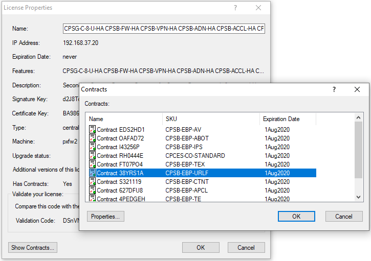

I updated the contract file yesterday, and by way of example with one of the clusters, one member in #cplic print shows the updated renewal date 1 AUG 2020. The other cluster member still showed the old date of 1 AUG 2019. As I have the magic tick box ticked which automatically checks and updates I thought I'd leave it over night and check this morning. Today that member is up-to-date. Great! But there is still a problem...
To illustrate this I have some screenshots from the aforementioned cluster member.
1) #cplic print. Notice all blades are good until 1Aug2020 - including the URLF blade.
2) SmartUpdate. Again, notice all blades are good until 1Aug2020 - including the URLF blade.

Update on this case... A few very helpful Check Point people saw this and contacted me offline to help. After lots of trying different things and capturing debug info, we got there. One of the gateways was failing due to something on Check Point's side. Someone did something with the CK of the gateway and said "try again now..." and hey presto, it worked!
Some of the other gateways were still failing and turns out it was because they didn't have access to sync up with Check Point's cloud. The gateways in question are internal and air-gapped, so didn't have Internet access. So even though you pay your money, download the new contract and apply it via SmartUpdate, it has no effect until the gateway has "checked in" with Check Point cloud. I'm still questioning with CP how we activate contracts for air-gapped gateways that cannot be connected to the Internet.
That was my understanding too, and always used to be the case but I suspect CP have twiddled with something recently? In my recent case, even with it downloaded and applied via SmartUpdate, and #cplic print showing the new contract date, other places such as the Device & License Info page in SmartConsole, and #cpstat appi -f subscription_status showed certain blades (such as App Control in this case) NOT updated, and it wouldn't actually update and work until it had sync'd with the cloud. I'll pay special attention to this next time I have a renewal coming up and see if the same applies.
Yep. I raised a TAC case and was told it was cosmetic and he closed the case without further discussion. Frankly this is not a satisfactory answer, and when some blades show updated and others don't it doesn't give any confidence that it will work on the strike of midnight at renewal time. However from this thread I also had a couple of people from QA and R&D getting involved and they spent several days working on this with me giving amazing support. It's all working now, but there's still a question mark over how new contract files are actually activated on gateways without Internet access. And the consistency over what is displayed in the device status page (two members of the same cluster showed different results after the contract had been updated - some dodgy coding that needs sorting out!) One for everyone to be aware of, and I'm be interested to know if anyone else has the same problem in the future. The other CP people who helped me on this case have said is that gateways need Internet to sync to the cloud and activate the license, but that doesn't answer how SCADA and other non Internet facing gateway work come renewal time. On current evidence I think CP need to re-think the whole "must sync to the cloud to activate" idea - or go back to offering a working alternative of applying the contract file manually offline, as always used to be the case.
To add to this as a me-too story - We also had the same issue at our last contract rollover. We went through all the usual processes to ensure the correct updated contract file was installed and the gateways had Internet access. Contract info looked fine. The IPS blade was showing the new expiry, but Anti-Bot, URL Filtering and Application Control stubbornly indicated as 'about to expire'.
We were also told it was cosmetic and to wait it out. Though also were offered the option of applying an evaluation license to cover the rollover date. It is apparently expected behavior with Enterprise Based Protection contracts, as per sk105057 (this SK has only recently become public).
We decided to wait it out, and discovered it was definitely *not* cosmetic. Our URL filtering and Application Control blades indeed disabled on the rollover date. The notable effect was these blades failed open, and that websites that are normally blacklisted became accessible.
We applied eval licenses to all but one of the affected gateways which re-enabled the blades. Just out of curiosity we left one gateway without an eval license, to see if it self corrected over the day. Given being in NZ we're GMT+12 I wondered if the centrally managed rollover dates were GMT based and not accounting for local timezones.
Indeed the next day that gateway self-corrected, and started showing the new contract expiry, with the blades re-enabled. I removed the eval licenses for the other gateways and confirmed they were also now all showing the new contract expiry.
