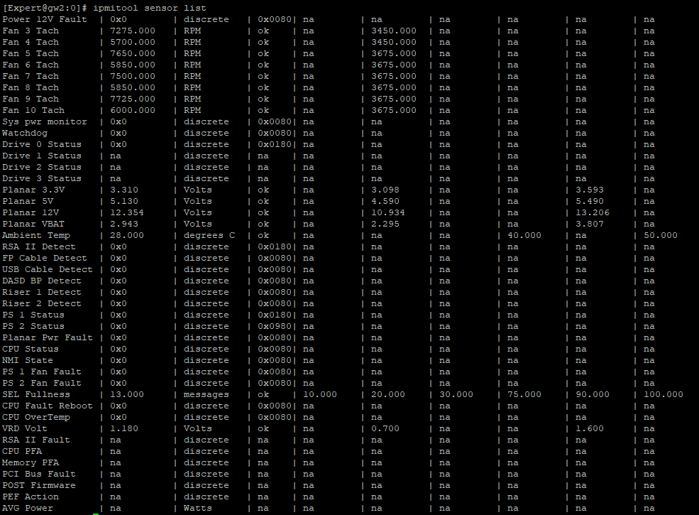

# ipmitool sensor list
# ipmitool fru                                                    -> power supply info
# ipmitool sdr elist full                                    -> electrical information (3.3V, 5V, 12V)
# ipmitool sdr type temperature                    -> temperature
# ipmitool sdr entity 29                                    -> fan speed
# ipmitool sdr type "Power Supply"               -> lost power on power supply xyz

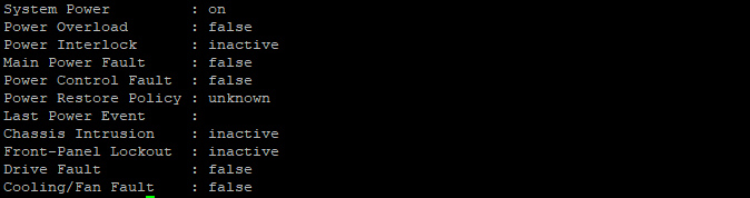

# ipmitool chassis status ipmitool chassis identify
