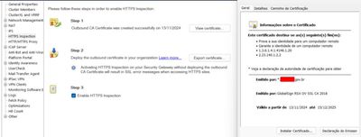

I would like to share with you the following issue that I am facing with at a client.
The environment has a simple cluster with 2 (two) members in HA mode. To better control internet surfing, we enabled SSL inspection. We were using a certificate generated by Active Directory and due to its expiration date being close, it was necessary to create a new one, however, this new certificate was generated by GlobalSign. The new certificate generated by GlobalSign was imported via Smartdashboard and when we validated internet access, the client reported that no website would open due to the firewall certificate error, according to below:
Below, the certificate that was imported to firewall and machines from environment:
In my opinion, this issue should not occur, since we imported a valid certificate to the firewall, the only difference being that the previous certificate was an internal CA (Active Directory).
I did not find any documentation that mentions that the certificate for SSL inspection must be from an internal CA and not from a valid CA. Could you explain why this issue occurs? Does this behavior make sense for you?

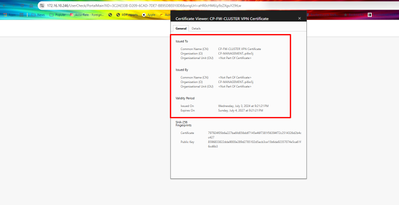

Maybe wording might not be 100% correct, but here is example in my lab. Think of mgmt as actual CA,if you will (certificate authority) and the actual "gw" cert as sub-CA that generates on the fly cert for the clients. I attached screenshots of all this and more than happy to show you in my lab.

As expected, the certificate provided is NOT a Certificate Authority certificate, but a wildcard certificate for your domain.
This certificate cannot sign certificates for other domains, which is required for HTTPS Inspection to function.
You need a Certificate Authority key to use HTTPS Inspection.
This can be generated from SmartConsole itself:
Or can be generated from any PKI (even via an OpenSSL command line).
A public CA (like GlobalSign) will NOT issue you a CA key that is globally trusted for this purpose.
The CA key must be explicitly configured on the clients as trusted (can be done through GPO or similar).
