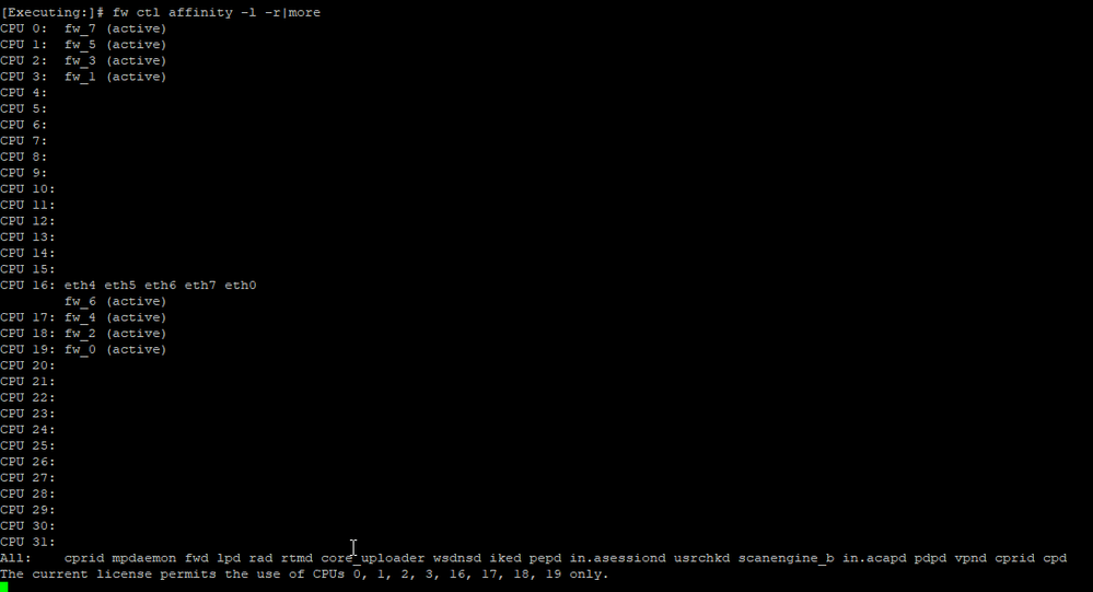

Few days ago we detect a core going to 100% with no apparently reason.
We check it using cpview -> CPU -> Top-Connections and discover that was one computer reaching some IP.
I reach the user and he explain was uploading a 42Gb file to a Sharepoint suppliers site for some specific work.
We check the distribution of cores using fw affinity, and apparently CPU 16 is taking care of several interfaces.
FW is part of a ClusterXL.
Blades: fw vpn cvpn urlf av appi ips identityServer SSL_INSPECT anti_bot ThreatEmulation mon.
We are concern because this was generated by one user, and we want to get ahead in case more users start doing things like this.
Probably someone all ready had this issue before and have some recommendations.
¿Is there a way to "adjust" this procces/connection? Meaning, is recommended to set manually the distribution of cores for the interfaces? how?
We could set a drop rule to that user to that IP, could it work? Or the CPU will keep reaching 100% (we didn't test it).

Your code version and Jumbo HFA? Looks like Dynamic Split/Workloads is not active.
You are experiencing what I called the "core crunch" in the third edition of my Max Power book (pages 214-215). You are only licensed for 8 cores (really 4 physical cores w/ SMT) yet you have 8 firewall worker instances defined. So essentially many cores are pulling double duty as both SNDs & Workers in basically an 8/8 CoreXL split. This is very bad for performance as you have experienced.
You probably need to run cpconfig and reduce the number of firewall worker instances from 8 to 6 so that one of your physical cores can be dedicated to SND functions on two SND threads via SMT, but I'd advise providing your code version and posting the outputs of the "Super Seven" commands to this thread first before taking any action:

We're on R81.10 Jumbo Hotfix Take 110.
We've licensed 4 core instances and got duplicated due to hyperthreading. We can change the number of fw worker instances on a window.

Is this firewall open hardware (i.e. not a Check Point appliance) or a VM? That would explain why Dynamic Balancing and possibly USFW is off.
If you want to stay with a static CoreXL split (or can't use Dynamic Balancing), definitely change number of instances to 6 to give you a 2/6 split.

Based on those outputs 6 instances with a static 2/6 CoreXL split should be appropriate, then you can re-assess.

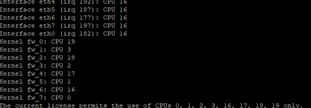

We've changed the corexl distribution using cpconfig but we lost one CPU (CPU 16) for SND (or at least is not showing up on the commands). I think is related to the amount of licensed cores that we've, which is 4 by the way; based on sk98348.
Below are some screenshots.
Thanks in advanced.
Your split is 2/6 regardless of what those screenshots say; multi-queue should be on by default for all interfaces that support it. What is the driver type reported by ethtool -i (interfacename) for all your interfaces?

eth0-eth7 are using Broadcom driver tg3 and do not support Multi-Queue, this is the reason core 16 (sibling core to CPU 0 under SMT) is not showing up. However this is the optimal configuration since your single SND instance has exclusive access to CPU 0 to handle all interfaces and does not have another SND instance trying to compete for the same physical core via CPU 16. Assuming you don't rack up greater than 0.1% RX-DRP vs. RX-OK in output of netstat -ni, your single SND instance should be fine.
Broadcom NIC interfaces are usually the low cost bidder for inclusion of their NICs on the server motherboards, and do however suck quite mightily once they get put under load. But perhaps after having 10+ years to straighten out and stabilize their crap drivers, maybe Broadcom has finally has managed at long last to do so...maybe.
R81.20 will not make a huge difference to you here since you are on open hardware which does not support Hyperflow nor Dynamic Split. I'd just make sure you have the latest recommended R81.10 Jumbo HFA applied.
