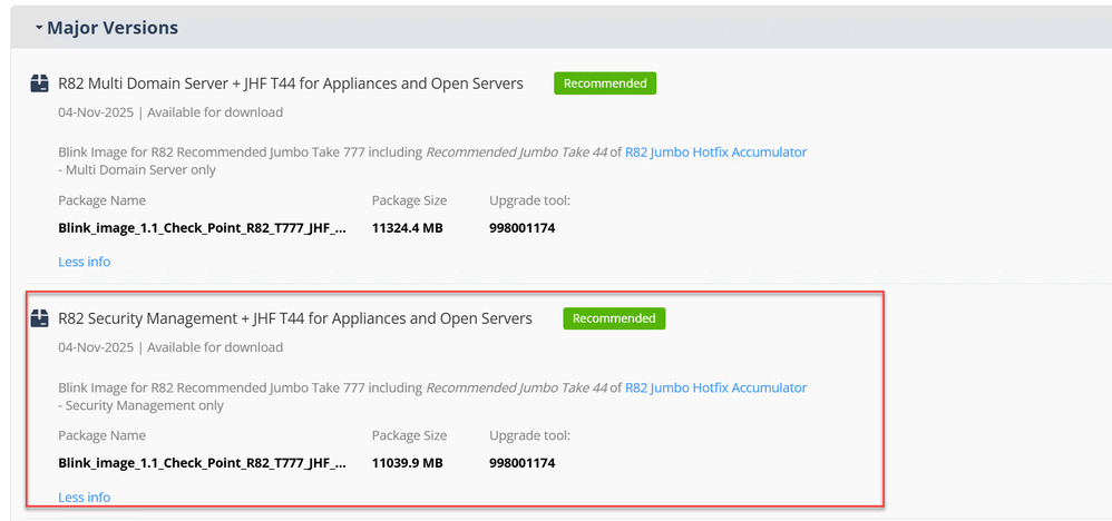

My team upgraded all of our managements the week after R82 was declared the recommended version. We also upgraded about ten clusters a week or two after that, including five of them in a single CDT action.
Blink failed to upgrade our managements to R82 jumbo 34. Maybe it will work to jumbo 44 for you. I would download the R82 upgrade image and jumbo 44 to keep locally on the boxes in case you need to do the upgrade and jumbo separately. Note that management upgrades to a new major version often take 2+ hours. If you have to do the two-step process, the jumbo takes much less time than the upgrade does.
Once you have the management upgraded, import the packages into the SmartConsole package repository. That upgrade method works really well for firewalls. Select one or more clusters, right-click, Actions > Version Upgrade, and point it to R82.
Thanks for that. In the past when I have downloaded the package for the firewalls, it stills seems to download from the internet when you start the update. So I stopped doing that.
If the system is downloading the upgrade image again, then something is wrong with how you imported the image you downloaded beforehand. I find the User Center is always misbehaving at exactly the wrong moment (down for maintenance, it takes over an hour to download anything, or whatever), so I keep local copies of the latest CPUSE build, the ISO and CPUSE package for each major version we run, and all the jumbos we run. I copy them to the systems well ahead of my windows, and the systems never download any of them directly from Check Point. It keeps the upgrade windows predictable.
