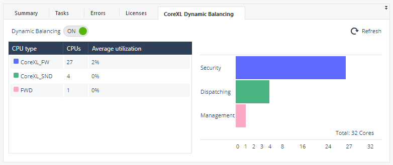

SmartConsole Extension to manage sk164155 - Dynamic Balancing for CoreXL & HyperFlow.

HI @Mark_Gurevich ,
please try my helper extension https://dannyjung.de/smx.json and check if these conditions are met:
['type'] == 'CpmiClusterMember' or 'simple-gateway'
['os-name'] == 'Gaia'
['version'] == 'R80.40' or startsWith('R81')
['hardware'].endsWith('Appliance') or ('Appliances')
HI @Mark_Gurevich ,
['type'] == 'CpmiClusterMember' or 'simple-gateway' ['os-name'] == 'Gaia' ['version'] == 'R80.40' or startsWith('R81') ['hardware'].endsWith('Appliance') or ('Appliances')

;HI,
I have a quick query re: the extension. I have added it and it works to a point. I have to 'Load' it; approve the script commit, the look at the task results. In other words I don't see the output in the window as shown in my attached screenshot. I am running the 80.40 SmartConsole Build 416.

;Hi Danny,
I'm trying the CoreXL balancing extension., and getting error: Loading Error: ERR_CONNECTION_TIMED_OUT
New to these addons and I only added the extension to SmartConsole, is there any other basic pre-reqs for extensions to work ? Any requirement to reboot SMC or gateways ?

;There are not other requirements. Which SmartConsole version and build are you using? Does your SmartConsole has direct internet access or is there a proxy in between? Where exactly does the error message appear?
Hi Danny,
Its SmartConsole R80.40 Build 416. There is indeed a proxy in between. (Isn't this a security community, why would we let a random connection get to the Internet unchecked ... 🙂
The error appears in extension panel on SmartConsole, see snip.

Troubleshooting SmartConsole Extensions - sk166932 <- set UseDefaultWebProxy=true and it should work.
Excellent - that worked, thanks.
For me I had to add UseDefaultWebProxy=true in SmartConsole.exe.config. Then I had to add the proxy Ip in the GUI clients on the SMC.
On one SMC I found the API service had crashed 😟 so had to restart it. ( More work, I suspect possible memory leak in 80.40 JHFA Take 91 for management)
That SK was hard to find, perhaps pin to Extensions forum, very useful
Anyway, extension now working. Great tool and thanks again

Hi Guys,
I'm also trying to enable it in our env, however, when I click on load button nothing happens. We are using R80.40 GA 118 take, no proxy involved and smartconsole 416 build.

;Very nice visualization of what is going on from a performance perspective, looks like the days of figuring out what obscure command to run to see what is going on is finally past! Nicely done!
Does anyone know if this feature is supported on the Quantum Light Speed Appliances, in particular on the 450?
I would like to enable it but get an error message:
Dynamic Balancing Status - Off (Stopped due to State Verification failure)

@CheckPointerXL Hyperflow is not available in R81.10, but Dynamic Balancing is, assuming your GWs have at least 8 cores. The extension should work on R81.10, but I will let @Danny to confirm this.

;@CheckPointerXL : This extension was tested to work with R81.10 on 32 core appliances and bigger ones. Your comment sounds to me that you are unable to activate dynamic balancing. If this is the case, please open a service request with TAC.
