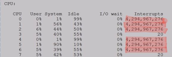

Hello CheckMates,
since two days we see this very low interrupts, normally all cores around 100.000
Looks like everything is running fine but I'm wondering.
Has anyone an idea ?

I have a suspicion that cpview is reporting false values in this view. With R80.20/R80.30 many CPU interrupts are displayed equally. That can't really be right.
Furthermore, I also don't believe that a CPU  can handle 4.xxx.xxx.xxx interrupts per second. The CPU clock should be slower than the interrupt value 🙂 So it must be a reporting issue.
I have noticed the same behaviour with many firewalls. Maybe Check Point should take a look at this. Or you should open a TAC case.

strange, from time to time it looks like this:

This happened to one of my 13800 gateway. All of a sudden one day it starts showing almost similar behavior like yours. We did not find what was causing this but after the upgrade from R80.20 T47 to T103 this problem was over.

We have the same problem.
FedericoMeiners
Advisor
@Wolfgang
Happened to me in many customers running R80.20.
We opened a SR and the TAC told us it was only a cosmetic error.

Seen this many times and it is just cosmetic.  I think it is some kind of counter overflowing, similarly to how very large numbers can sometimes be displayed as a negative number because the binary representation got so large it flipped the first/leading/leftmost bit from 0 to 1, and the counter was a signed value, where a leading bit of 1 indicates a negative number.  There is probably some significance to the number 4,294,967,276 when viewed in binary format, but it is Friday afternoon and I'm not in the mood to do binary math at the moment...another time perhaps.  😀

I did the math for us one Saturday night.
Linux 32-bit systeme modern int32_t or uint32_t with the max value unsigned 4.294.967.295 and signed from −2.147.483.648 to 2.147.483.647.
Is very near to this value 4,294,967,276. If we do the math, we might get the right interrupt value:
    4.294.967.295
  - 4,294,967,276
                       19
I think someone has programmed a typical int32_t vs. uint32_t overflow error when the mathematical signs change.
Solution:
Add this code in cpinfo.
if( interrupt  > 2.147.483.647 ) {
  interrupt = 4.294.967.295 - interrupt;
What surprises me even more is that the same error with the same mathematical value (4,294,967,276) appears in several cpu lines. A small error has occurred during programming of this code.
@PhoneBoy Maybe you could forward this to TAC or R&D.
PS:
But that's also how I messed up my grade in c++ programming during my studies.😁

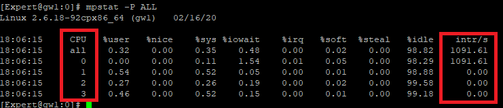

I have found a solution to the problem 🙂
You can use the following CLI command to display the interrupts per second:
# mpstat -P ALL
