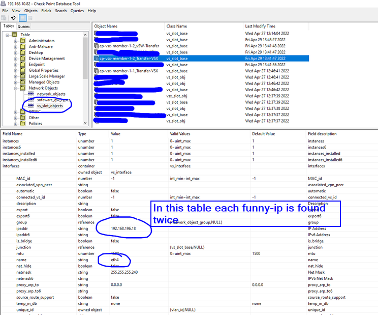

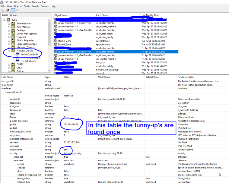

It is possible to change the funny-ip's via GuiDBedit. The funny-ip's from the backup member were change. There are three positions for each funny-ip.
After saving the changes, GuiDBedit can be close. Now open the Smart Console and do a "Publish".
In the next step, I reset the VSX-cluster member with "reset_gw" via direct console connection.
The last step was a "vsx_util reconfigure" and a policy install.
