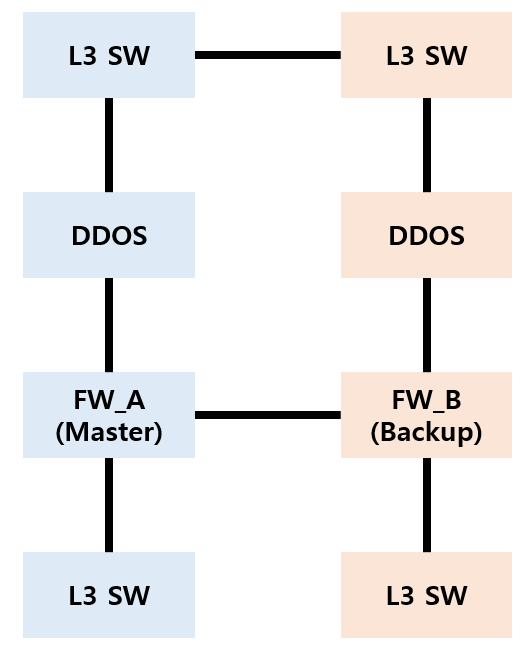

the customer company consists only of an external interface and an internal interface, and it is VRRP.
As for the issue, when Bypass mode is activated in the DDOS device above the Check Point firewall, the firewall will be in the following state.
FW_A, External Interface = Master / Internal Interface = Master
FW_B, External Interface = Backup / Internal Interface = Master
We tested the internal interface by directly connecting the firewall to each other, but the results were the same, and we also confirmed that the hello packet was sent normally.
