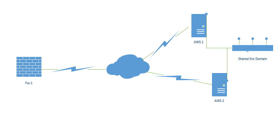

Hi Community.
With the increase in popularity of AWS, we have been receiving many requests to set up or troubleshoot VPNs of this kind.
One of the most popular calls is due a VPN outage caused in deployments with static routes (sk100726) where customers have ticked the "ping" checkbox in the route, as mentioned in the sk by the way.
From time to time the route disappears from the route table and thus traffic is not forwarded.
This is fine, you remove the tick from ping checkbox in the static route and everything is back to normal (many TAC cases opened confirming this)
But this raises the question that automatic redundancy does not work and that sk100726 gives a false sense of security.
What's your approach when configuring mesh tunnels like these towards AWS?
Has anyone tried sk164355? Is BGP the best option?
Thanks in advance
