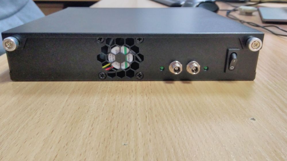

Rear view of the appliance. Switch on the right is not power on/off but a reset button. It is powered on automatically:

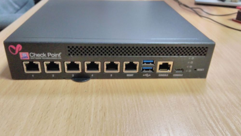

Front view exposing different ports and a pull out ID tag:

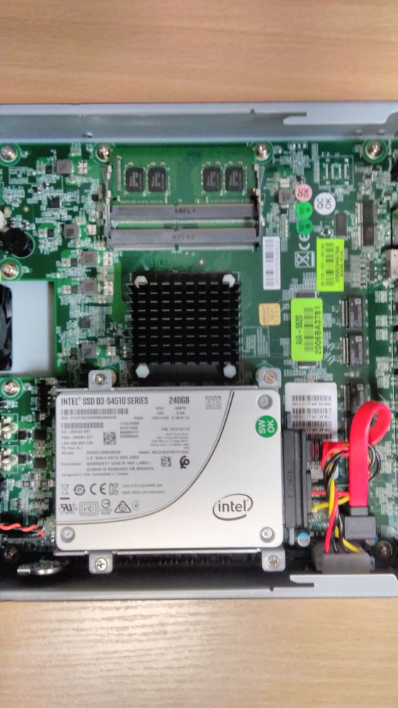

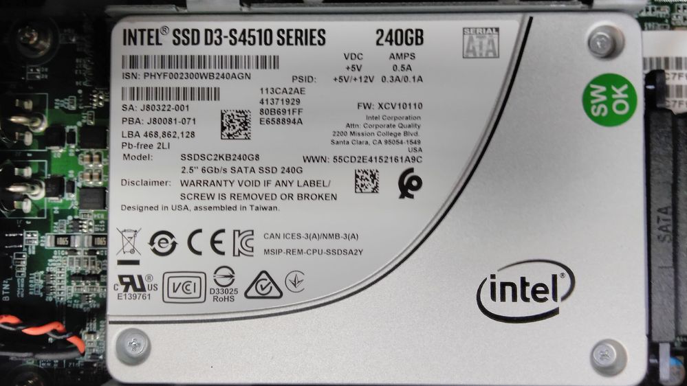

Inside there are the motherboard, Intel(R) Atom(TM) CPU C3558 @ 2.20GHz CPU, 1x DDR4 8GB DIMM, 240GB Intel SSD:

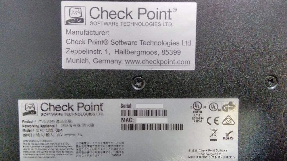

Stickers on device bottom panel:

Disk Info:
/dev/sda:
ATA device, with non-removable media
Model Number: INTEL SSDSC2KB240G8
Serial Number: PHYF002300WB240AGN
Firmware Revision: XCV10110
Media Serial Num:
Media Manufacturer:
Transport: Serial, ATA8-AST, SATA 1.0a, SATA II Extensions, SATA Rev 2.5, SATA Rev 2.6, SATA Rev 3.0
Standards:
Used: unknown (minor revision code 0x006d)
Supported: 10 9 8 7 6 5
Likely used: 10
Configuration:
Logical max current
cylinders 16383 0
heads 16 0
sectors/track 63 0
LBA user addressable sectors: 268435455
LBA48 user addressable sectors: 468862128
Logical Sector size: 512 bytes
Physical Sector size: 4096 bytes
Logical Sector-0 offset: 0 bytes
device size with M = 1024*1024: 228936 MBytes
device size with M = 1000*1000: 240057 MBytes (240 GB)
cache/buffer size = unknown
Form Factor: 2.5 inch
Nominal Media Rotation Rate: Solid State Device
Capabilities:
LBA, IORDY(can be disabled)
Queue depth: 32
Standby timer values: spec'd by Standard, no device specific minimum
R/W multiple sector transfer: Max = 1 Current = 1
DMA: mdma0 mdma1 mdma2 udma0 udma1 udma2 udma3 udma4 udma5 *udma6
Cycle time: min=120ns recommended=120ns
PIO: pio0 pio1 pio2 pio3 pio4
Cycle time: no flow control=120ns IORDY flow control=120ns
Commands/features:
Enabled Supported:
* SMART feature set
Security Mode feature set
* Power Management feature set
* Write cache
* Look-ahead
* WRITE_BUFFER command
* READ_BUFFER command
* NOP cmd
* DOWNLOAD_MICROCODE
* 48-bit Address feature set
* Mandatory FLUSH_CACHE
* FLUSH_CACHE_EXT
* SMART error logging
* SMART self-test
* General Purpose Logging feature set
* WRITE_{DMA|MULTIPLE}_FUA_EXT
* 64-bit World wide name
* IDLE_IMMEDIATE with UNLOAD
* WRITE_UNCORRECTABLE_EXT command
* {READ,WRITE}_DMA_EXT_GPL commands
* Segmented DOWNLOAD_MICROCODE
unknown 119[6]
* unknown 119[8]
* Gen1 signaling speed (1.5Gb/s)
* Gen2 signaling speed (3.0Gb/s)
* Gen3 signaling speed (6.0Gb/s)
* Native Command Queueing (NCQ)
* Phy event counters
* unknown 76[15]
* Software settings preservation
* SMART Command Transport (SCT) feature set
* SCT Write Same (AC2)
* SCT Error Recovery Control (AC3)
* SCT Features Control (AC4)
* SCT Data Tables (AC5)
* reserved 69[2]
* reserved 69[3]
* reserved 69[4]
* Data Set Management TRIM supported (limit 4 blocks)
* Deterministic read ZEROs after TRIM
Security:
Master password revision code = 65534
supported
not enabled
not locked
frozen
not expired: security count
supported: enhanced erase
2min for SECURITY ERASE UNIT. 2min for ENHANCED SECURITY ERASE UNIT.
Logical Unit WWN Device Identifier: 55cd2e4152161a9c
NAA : 5
IEEE OUI : 5cd2e4
Unique ID : 152161a9c
Checksum: correct
