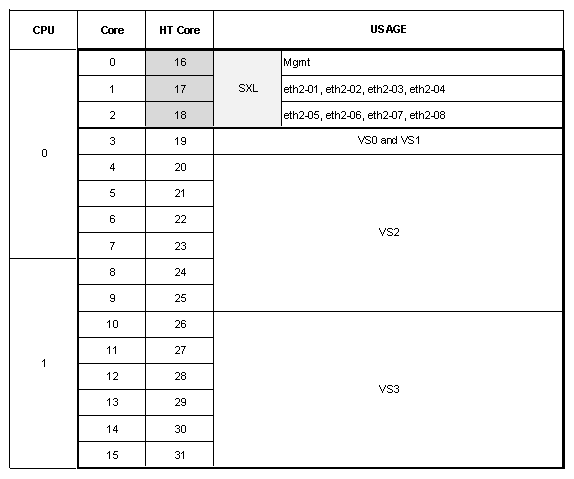

I would start with something like this. It's not ideal as VS-2 is stretched over 2 physical CPUs but it might help to fix overloaded CPUs
Note that cores 16-18 must not be used for FWKs at all! They are HT sibblings for cores 0-2 that are used for SND.

Actual commands to achieve this
fw ctl affinity -s -d -vsid 0 1 -cpu 3 19
fw ctl affinity -s -d -vsid 2 -cpu 4-9 20-25
fw ctl affinity -s -d -vsid 3 -cpu 10-15 26-31
