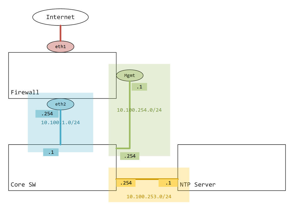

I'm having trouble getting the PBR configuration to work and could use some help.
Network Configuration
The firewall is connected as follows:
2024-09-17_19h21_39.pngeth1: Internet
eth2: Local Network (access to 10.100.0.0/16 via 10.100.1.1/24)
Mgmt: Management Network (10.100.254.0/24)
What I Want to Achieve
I want to synchronize time with the NTP server located at 10.100.253.1 through the Management network. However, due to the current routing, access to the NTP server goes through eth2. I want to correct this using PBR.

Note Locally-generated traffic is considered a limitation of PBR per sk167135
Perhaps a normal static route for the /32 can work for you (may also require an anti-spoofing exception).
