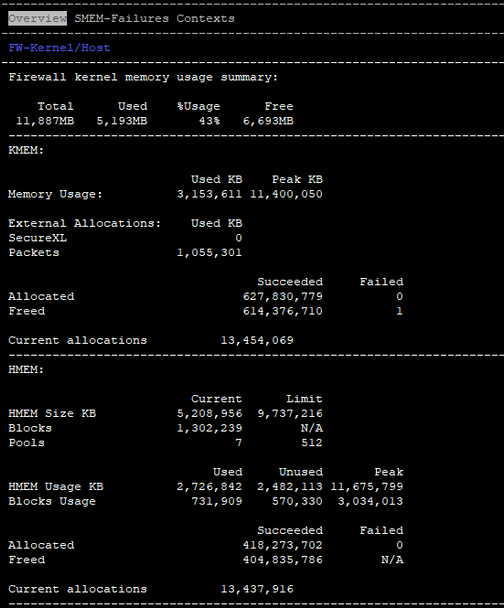

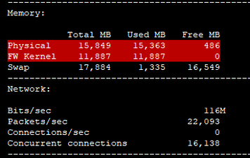

There is something wrong with the gateway and I can't figure out this... We had another occurrence again.
It was working just fine:
until few moments:

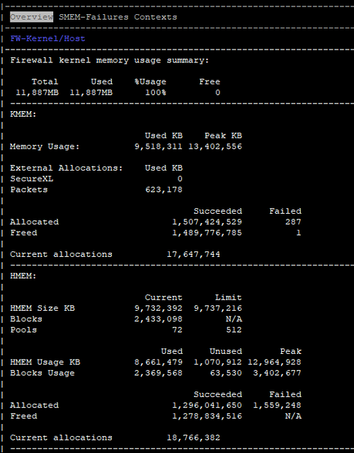

Please note FW kernel memory is fully used, operating system is using swap and connections/sec dropped to 0.
few more screenshots before the incident and after.
Is failed to allocate means it failed because there was no memory available, or it might suggest some hardware problems with memory itself?

By the way, I am seeing SMEM failures during out of memory events came from dlpk_cmi_internal_buf_init. What is this caller? We don't have DLP blade enabled...
#enabled_blades
fw urlf appi identityServer SSL_INSPECT content_awareness mon
So it looks like excessive memory use in kernel space which could be some kind of leak. To help isolate try this:
1) Uncheck the "Monitoring" checkbox on the firewall and reinstall policy. You will lose some of the advanced SmartView monitor reports but the "mon" blade will be disabled and if the problem will not recur that is the cause of the problem. If the problem still happens...
2) Enable Monitoring & disable Content Awareness next.
I'm guessing the memory leak is probably in one of these particular features.
