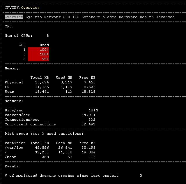

Hi, we're experiencing some high cpu usage and to be honest I'm not sure what to make of the cpview results. What is PM tier 1? Is it related to IPS?
Yes, using fw ctl fast_accel.
Refer to: https://supportcenter.checkpoint.com/supportcenter/portal?eventSubmit_doGoviewsolutiondetails=&solut...
I tried turning off ips but it didn't help
Pattern Matcher is used with any blade that is not Firewall and VPN.
That would include but isn't necessarily caused by IPS.

This is a bit concerning:
Accept Templates : disabled by Firewall
Layer CIRB incoming disables template offloads from rule #3
Throughput acceleration still enabled.
Layer RZ Inbound disables template offloads from rule #1
Layer OnPrem2AzureInfrastructure disables template offloads from rule #2
Layer Mtl2OnPremRZ disables template offloads from rule #1
Layer Azure2OnPrem RZ disables template offloads from rule #1
Layer RZ-OnPrem&Azure disables template offloads from rule #8
That said, most of your packets are accelerated, so this may not be a big deal.
You do have a large number of receive drops on your bond interface and on eth2, which might be something worth investigating.
What version/JHF are we working with here on what precise hardware?
output of enabled_blades would also be helpful to further contextualize this.
Also, you have 10 connections that are taking 92% of the CPU.
What precisely are these connections for and what precise policies relate to them?
Depending on what they are (and if they are trusted), we can fully accelerate them using fast_accel to reduce the overall CPU load.
I looked at the mentioned layers and rule numbers where it says disables template offload but I don't see/notice anything particular about them.
We're running R80.40 JHF 173 on a pair of HP Proliant servers. The connections taking all that CPU are from the backup server so they would be trusted. Maybe it's always been like that and I just happened to notice it today but I don't think so. Is it easy to fully accelerate the connections from that server?
once added should it be effective immediatly or just on new connections?
Given how SecureXL works in R80.20 and above, I believe it should be effective immediately.
However, it might require a new connection to be established.
