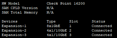

Greetings all,
Checking the memory in SmartConsole, its showing at 90%. below some info about the configuration
Here are the output of some memory commands:

Is there anything I can check to find what could be causing the high memory or whether there is any underlying issue that may need to be looked at further.
The only issue I see here is you're running an End of Support release.
Upgrade to a supported release.
Meanwhile, unless the system is dipping into swap (which it isn't here), high memory usage is not an issue.
The Linux kernel caches a lot of things for performance reasons.
Apart from version, which by the way might be relevant here and you should upgrade, if you can, to at least R81.20, preferably to R81.20, as its recommended version, plus handling of cpu/memory is WAYYY better than older codes.
Having said this, I can tell your issue seems to be corexl, as thats what seems to be related to memory spikes.
