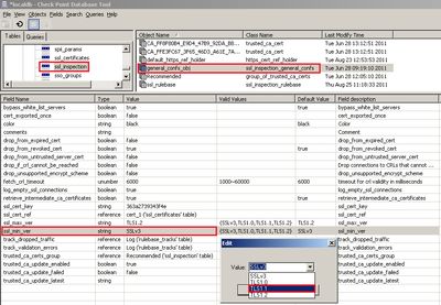

@G_W_Albrecht, Thanks for you answer. This gives a way to indeed get what I'm looking for. But not yet on the initial question. How do I explicitly disable TLS version 1.0/1.1 on versions higher than R77.30?
From sk107744 is this still the correct way?
Connect with SmartDashboard to Security Management Server / Domain Management Server.
Go to File menu - click on Database Revision Control... - create a revision snapshot.
Close all SmartConsole windows (SmartDashboard, SmartView Tracker, SmartView Monitor, etc.).
Connect with GuiDBedit Tool to Security Management Server / Domain Management Server.
In the upper left pane, go to Table - Other - ssl_inspection.
In the upper right pane, select general_confs_obj.
Press CTRL+F (or go to Search menu - Find) - paste ssl_min_ver - click on Find Next.
In the lower pane, right-click on the ssl_min_ver - select Edit... - select "TLS1.1" - click on OK:
Save the changes: go to File menu - click on Save All.
Close the GuiDBedit Tool.
Install the policy onto the relevant Security Gateway / Cluster object.
Or do we need to use the cipher_util to implicitly disable old TLS versions to get the job done? Maybe it's my way of explaining things here but i don't seem to get 1 clear answer for this.

So eventually i just tested this out in my lab(SMS on R81.10 and (VSX)Gateway on R80.40).... I can confirm that you have 2 options:
Option 1 - use GuiDBEdit
Note: Database Revision Control is not supported for VSX objects (sk65420).Close all SmartConsole windows (SmartDashboard, SmartView Tracker, SmartView Monitor, etc.).
Eventually after testing your new settings, you will see the following logs appearing when trying to connect with TLS1.0/1.1 (Don't mind the strange SSL2.0 message...)
Option 2 - Use the cipher_util
Via this route you can implicitly rule out cipher strings which are also available for TLS1.0/1.1. As discussed above you can use(for example) the cipher list that @G_W_Albrecht provided to achieve the same goal as option 1. The only thing is with option 1 you are certain(because you explicitly configured it) these old TLS versions cannot be used anymore.
