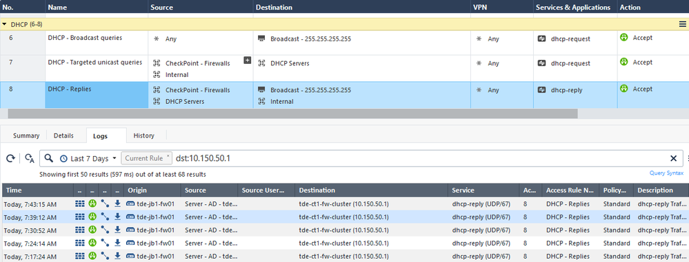

We configured central DHCP relaying, using new services, by following SK104114 and it works perfectly if we are relaying locally (receiving DHCP broadcasts on a locally attached VLAN and sending unicast queries to the DHCP servers).

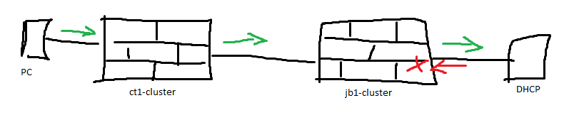

We've however deployed a second firewall and the firewall that is local to the DHCP server drops the packet although the policy matches with 'Allow'.
My artwork:
Policy:
Debug information:
fw ctl zdebug -T -e "accept host (10.150.50.1) and host(192.168.141.220) and port(67);" -m fw + vm drop

If I edit the default objects 'dhcp-request' and 'dhcp-reply' to remove the 'Match' strings, as shown here, it breaks DHCP relaying altogether:
I presume this is a bug?

Hi Heiko,
I did try that but the first firewall then simply ignores the broadcast and doesn't send anything on to the 2nd firewall which has the DHCP servers.
I understand ClusterXL DHCP relay to require policies with the new service objects that do protocol analysis...
Regards
