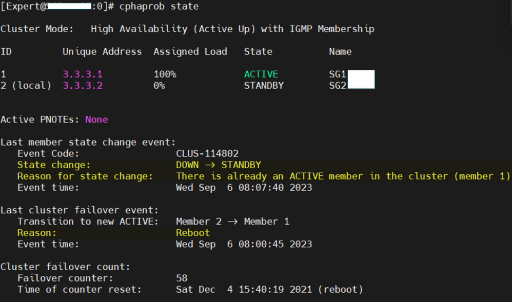

Hello,
Is there any "practical" way to validate the reason "why" our ClusterXL did a failover?
We want to rule out that it was a CPU problem and / or equipment configuration.
The cphaprob state, shows the following.
Is there any other documentation to check in these "situations"?

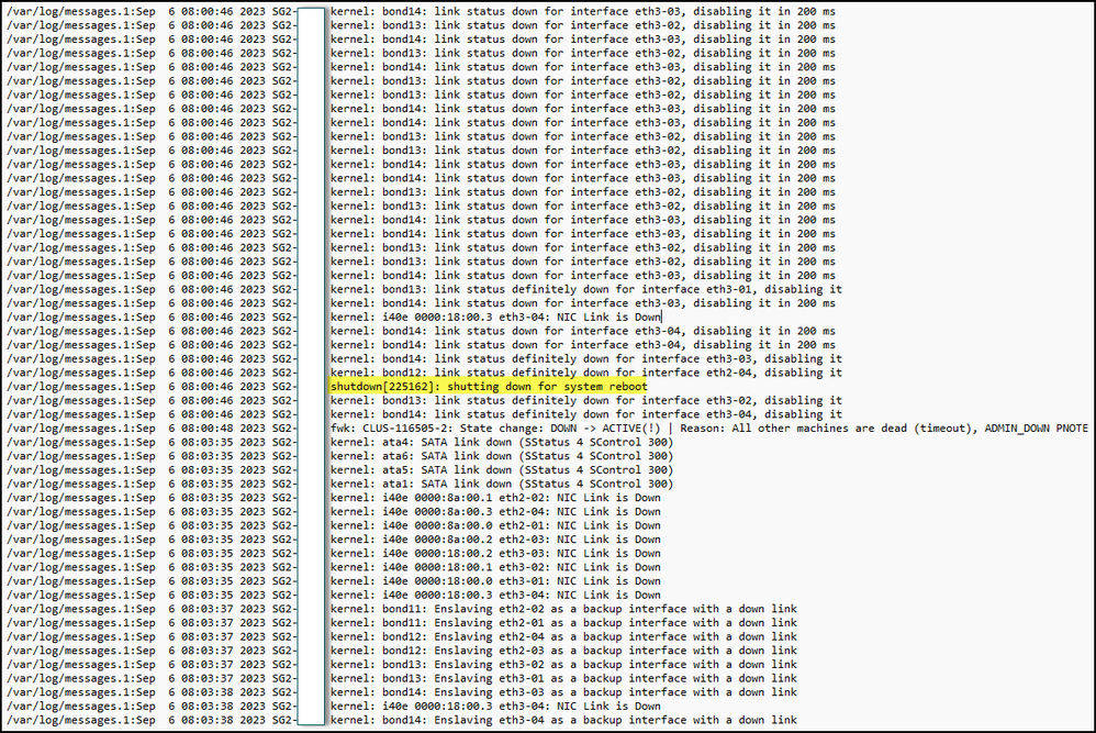

Andy,
I found this, with the command you recommended.
I have the impression, and I am almost sure, that it was a manual "shutdown" of the equipment, either it was disconnected from the mains, or something similar.
By the way, in your command grep -i DOWN /var/log/messages* ... how can you filter the date only for today, 06September?

the_rock
Legend
Legend
Yes, there are ways to tell...
Btw, I would NOT be using routable IPs for sync, as 3.3.3.x is Amazon range...I always tell customers to use 169.254.x.x range
Anyway, having said that, I would run below and look for messages in proper date/time span
from expert -> grep -i DOWN /var/log/messages*
Matlu
Advisor
Andy,
Cheers, 🙂
the_rock
Legend
Legend
There ya go bro, thats your answer : - )

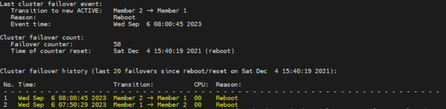

Bob_Zimmerman
Mentor
Mentor
cphaprob show_failover
This shows a log of up to 20 failovers going back to the last time services were restarted. It doesn't always give a lot of detail. It also doesn't contain state changes which did not result in a failover (like standby to down).

Matlu
Advisor
Hello,
This is a bit of a silly question, but when you apply the command, like:
cphaprob show_failover, the result says something like.
"member2 -> member1"
It's silly the doubt, but by "member2" do you mean, the same computer, where at that moment, I'm running the command?
Greetings.
the_rock
Legend
Legend
It would show you exact same output on both, but no matter the context, it would look at member 2 as current standby and member 1 as active.
