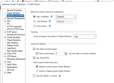

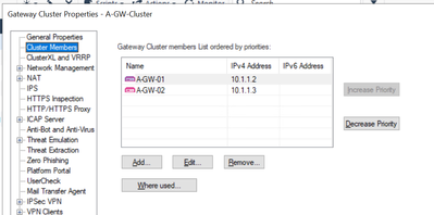

Gateways 01 and 02 are already setup as an A/S Failover cluster (HA mode), using ClusterXL and VMAC.
Our basic configuration details:

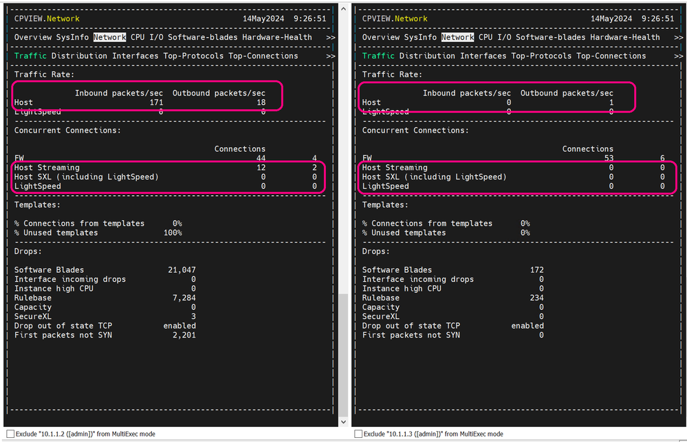

So with the lab up and running, it is time to generate some traffic so we can see which gateways are actively handling traffic. Spinning up a browser in both my server VMs I started some classic YouTube streams.
Using MobaXterm I connected out via SSH to my gateways launched cpview to take a look at how the traffic is distributed.
(By the way, if you are not familiar with it, play around with MultiExec mode, it is super handy.)
As you can see Gateway01 is handling virtually all the traffic, which is what we expect in HA mode.

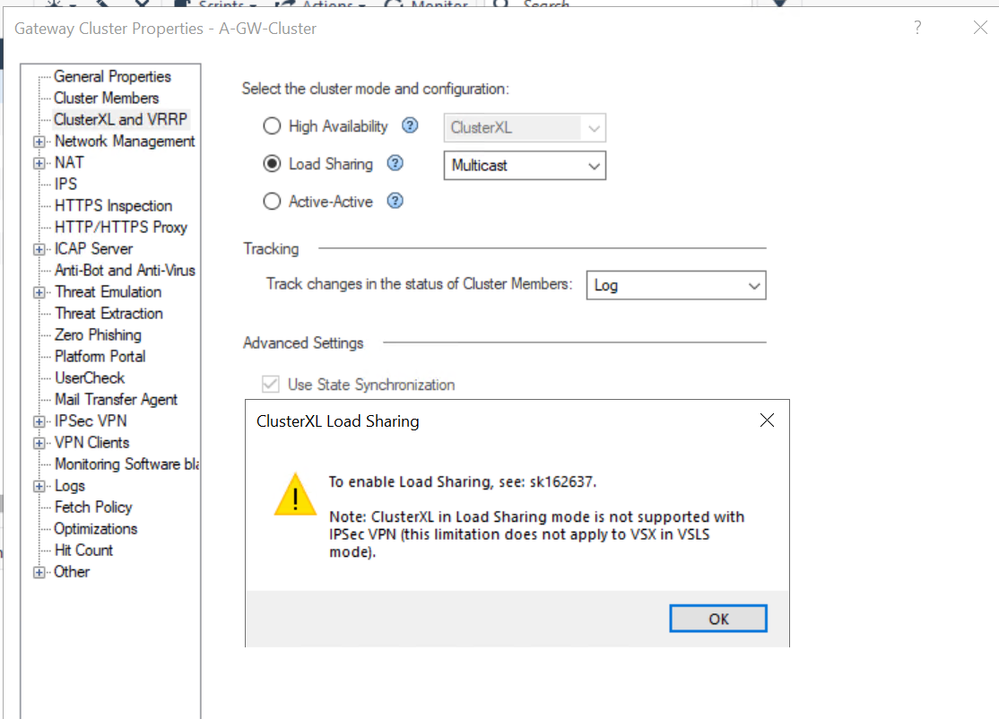

So with my lab prepped and my backups taken, I hopped into smart console to try flipping the switch on the cluster definition to see what happens.
Error Note: ClusterXL in Load Sharing mode is not supported with IPSEC VPN
Drats. I was immediately denied. Now, don't be deceived by this pop up warning. (I had to read it twice.) It can be confusing because it mentions IPSec VPN and then when you click OK, you are switched back to HA mode. This is Not failing because an IPSec VPN is present. (My lab setup doesn't have any) This is just the primary limitation the system wants to make you aware of. It is programmed by default with a speed bump of sorts here in the GUI.

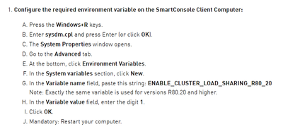

So while it is not a configuration issue, what we do have is something strange. The SK article gives you all the details on how to fix it but not the why this is in place. Basically, for some reason we have an extra protection built into both the Smart Console and the Management Server itself. This means that by default, with no customization, you cannot turn on LS mode! (This is true even if you build it from scratch.)

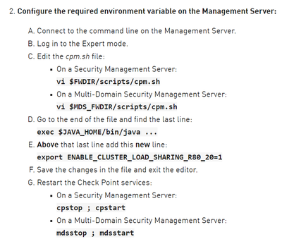

The way around this is fairly simple, if annoying. You have to create a variable on the computer running the Smart Console and update a script value on the management server. Nothing major, and no permanent damage done if you make these changes, just a hoop we have to jump through as a prerequisite. Consider it a test of character to keep out those faint hearted adventures who lack the courage to launch vi.
Link to the details:
https://support.checkpoint.com/results/sk/sk162637
Key points:
AND
Yes I know what you are thinking "Shouldn't I change that value to match my version, say R81_20 in this case?" The answer is No. It is forever locked in time at the version level it was created for as a memorial to forgotten code snippets that will never be updated.

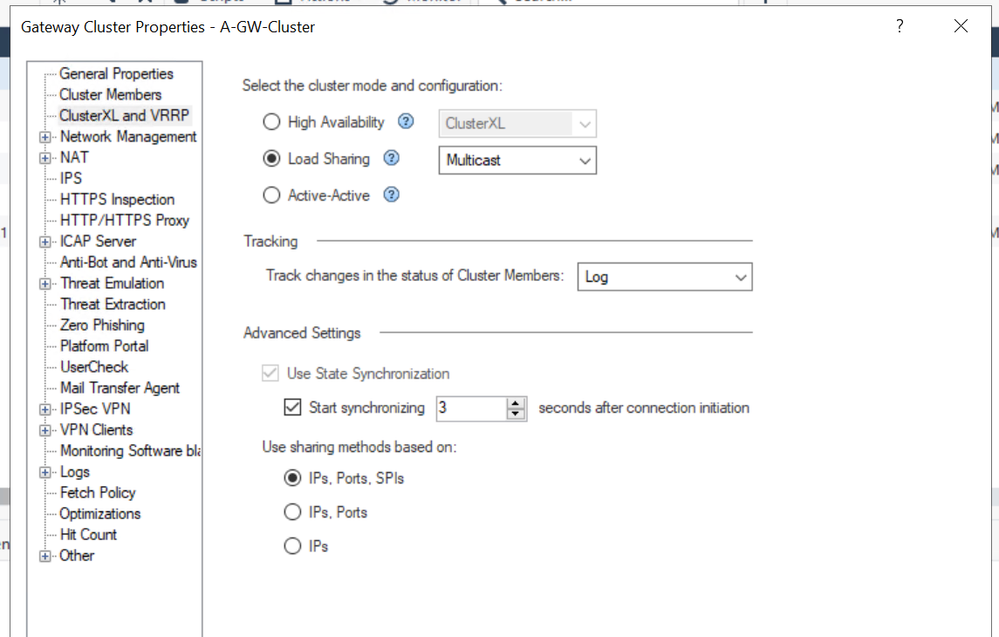

Anyway, after a short detour I finished prepping my system according to the SK article, I went back to try again.
Boom, now we are talking!

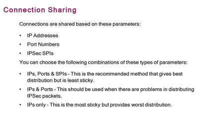

Note: For my test I went with Multicast mode for the 50/50 traffic distribution. I also selected the IP/Port/SPI connection sharing method. This has to do with which components of each connection request that will be used to calculate which gateway will own it. Rule of thumb here is more components considered the better the traffic distribution, but the lower the overall stickiness of connections. So if stickiness is more important to you than evenly balancing the load, you might pick IP only.

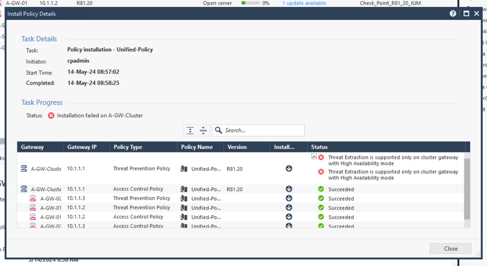

Right, well that was easy. Time to push policy…
Oops, looks like I stumbled over another limitation of LS mode. Simple enough to resolve in a test environment. Popped back into the cluster object and switched from Autonomous Threat Prevention to Custom so I could turn off Threat Extraction.
Note: Threat Extraction is an awesome protection feature and I don't recommend running without it in production environments. More info here:

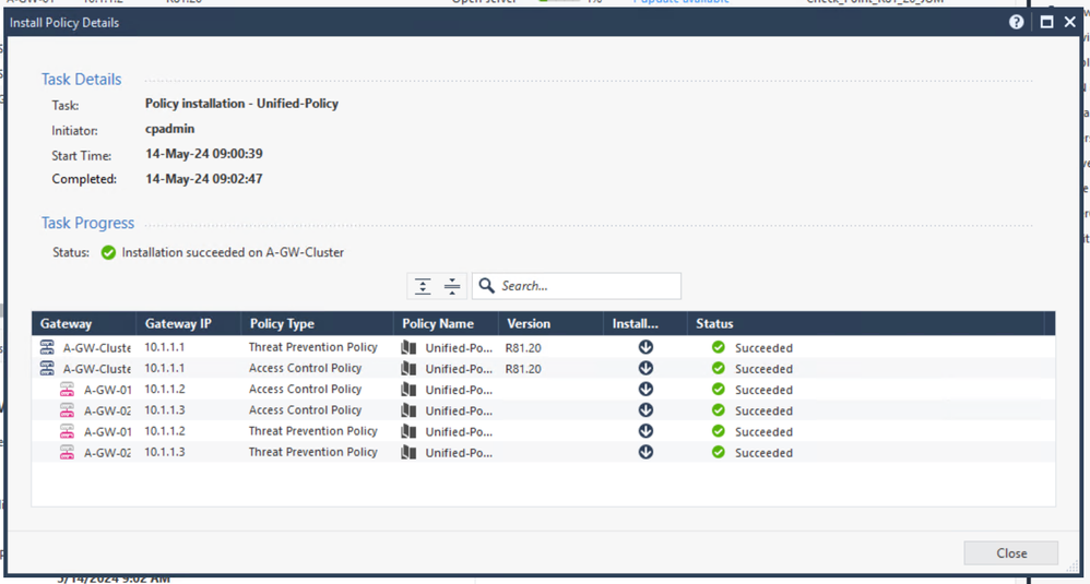

Then we try again:
That's better.
Went back to my test VM's, made sure internet access still worked, everything was good. Videos were still running as if nothing happened. To be safe, I relaunched my browsers and started up the streams again. Then reconnected to my gateways to see how my traffic is being handled.
Very nice! Now we have traffic seamlessly balanced across both gateways.
