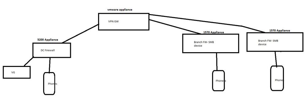

CP-VOIP-1.pngWe are facing a strange issue with SIP calls such as:
1) Phones behind SMB devices(brances) are not able to make calls to phones behind DC FW.
2) One way audio issues from phones behind SMB to phones behind DC FW.
3) We see two INVITE_SDP packets sent from phones and from Branch firewall tcpdumps however tcpdump on VPN GW doesn't show the second INVITE_SDP. After the first INVITE_SDP packet is sent, the PBX sends a 401 unauthorized message which the PBX vendor confirms is 'normal'.
We have configured custom 5060 service(without protocol) in DC, VPN and Branch firewalls however the issue still persists. We have also tried an 'any' rule but the issue is not solved.
We have tried enabling the VOIP option in the 1570 FW but no luck. At the same time, other tcp/udp communications from branch to HO are working absolutely fine.
Grandstream is our PBX solution. We do not have any NAT enabled for the site to site VPN.
Some of phones in the branches are working absolutely fine, we can make and receive calls without any issues. The OS versions were checked and we have working scenarios with R81.10.07 and not working scenarios with the same R81.10.07 version.
Any thoughts/steps would be really appreciated.
Thanks in advance for your time.

For all the 1570s are they running the same build of firmware: R81.10.07  (996001430)?
Which version/JHF is the datacenter 5200 firewall running with?

Some of the 1570s are running R81.10 and some are running R81.10.07. We have seen issues on SMBs running the latest firmware.
Somehow we are not seeing the second invite packet on the VPN GW FW.
