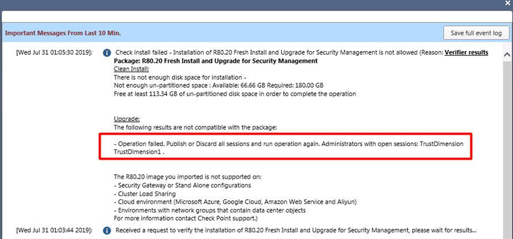

I'm unable to upgrade to R80.10 or R80.20.
Not from CPUSE:
And I got this error executing the migration export:
Any clues?, I tried first the upgrade to R80.20 (without success), and thent TAC say's it is recommended upgrade to R80.10 first... but I can't too.
Thank you!

Before we tried to do the upgrade from CPUSE,  I tried the upgrade using R80.20 upgrade tools, and I was getting this error:
“Operation failed. Publish or Discard all sessions and run operation again. Users TrustDimension and  TrustDimension1”
And obviously I checked the users and they do not have nothing pending to publish or discard, I even tried doing a change from each user session and I published the session and install the policy (Just In Case) but I got the same result.
After that, I modified the script to skip this validation about the users because is not true the pending publish or discard changes, and then the migrate export was successful.
But I got some other troubles when I tried to do de import on a fresh installed R80.20 machine, and as I said before, TAC suggest to try the upgrade to R80.10 first….
Now, I deleted the DA.log in order to send you a fresh log, and now I can see the events form CPUSE when I run the verifier:
As you see It’s the same error.
Thank you for your help and feedback.
