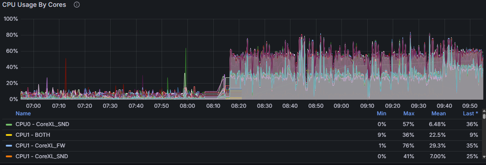

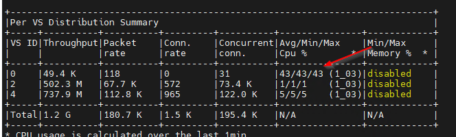

I have noticed something on one of my Maestro Appliance, the CPU usage in the VS0 is always so high. I can see the spikes in Grafana too. Although, the Appliances are not overloaded or anything, actually the other way around. I do not have a lot of traffic and the Appliance 9800 with 40 CPUs. And the same thing I see on the STANDBY appliance. In VS0 I have around 40% usage with some K Throughput Which does not make any sense.
VER. R81.20 Take 89
Is this a known issue or been solved with new Takes ?

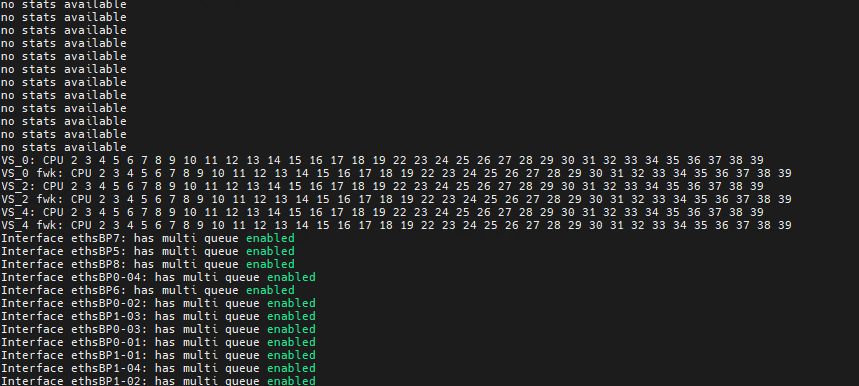

It could be that the VS0 CPU is shared by other VS systems. Please share output:
fw ctl affinity -l

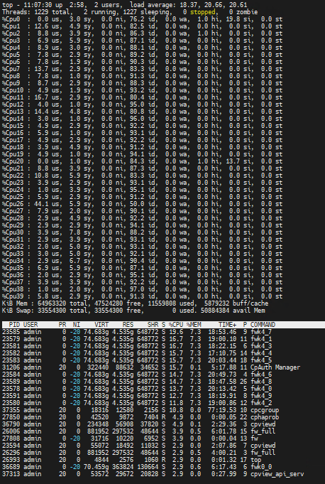

top, ps auxw and top -H could give more hints.

Also check with CPVIEW if the SND's are not very high loaded, this is also open bug.
fw ctl affinity -l
ps auxw output shows the bug that was posted above. I would upgrade. If you want to confirm open TAC ticket.
this one:
admin 825 4.3 0.0 8180 5684 ? S< 11:06 0:00 /opt/CPsuite-R81.20/fw1/Python/bin/python2.7_deprecated /opt/CPsuite-R81.20/fw1/bin/mq_mng -u
And many more in output
