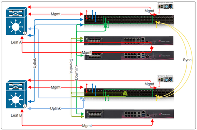

Starting from the connections and set-up, we're having a single site with 2 MHO's and each SG's connected in both.
Then we have the first 1 and 2 ports from MHO's connected to our ACI for SG Management - Vlan168 - and then the Uplinks on ports 5, 7, 8, 11 and 12) . For SG's - downlinks - we use port 25 (changed to downlink!) and 27 and 29 .

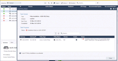

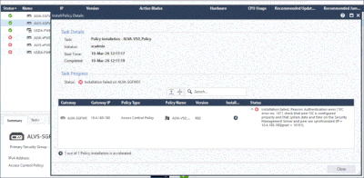

When we wanted to push an updated policy to the newly created SG - VS0 - we got several failures due to different SIC or communication issues (as per below examples). And the FUN begins 🙂 .
From the investigations we started with Support Engineer and our Professional Services guys, we noticed that for whatever reason, when we are doing SIC verifications from Management, either 2 times out of 5 or 3 times out of 5 we get different SIC errors like:

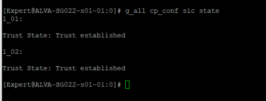

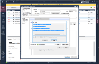

But when we check on the SG directly, we can see that SIC is OK.
That error shows only when we have 2 or more nodes in the Security Group, either with VSNext or without.

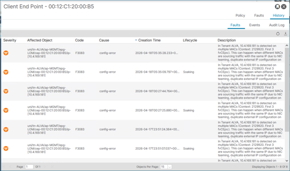

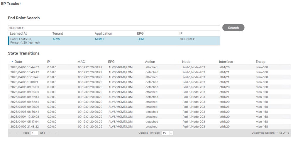

Not MAC filtering, MAC learning. If the ACI is learning MAC addresses from outbound packets, it's going to be constantly changing the MAC table for the magg interfaces, and packets are going to get lost, leading to SIC failures. On the SG management port, each SGM uses its own MAC address, so MAC learning can break things.
Sorin_Gogean
Advisor
As I know, we don't do any MAC learning/filtering on ACI side.
But, if we were to do any of that, we should have alerts on ACI side for MAC flapping and the Leaf ports that we have the Management connected - those first 2 ports from each MHO.
But since we are with only one port active right now, there is no MAC flapping, unless the Management IP - 10.18.169.41 in Singapore case - jumps between the 2 members for whatever reason....
I'll doublecheck and come back.
Thank you,
Sorin_Gogean
Advisor
As promised, we checked the ACI side for MAC flapping and we don't have any alerts for the ports that we use for SG Management.

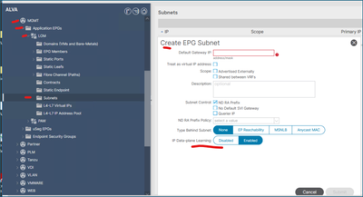

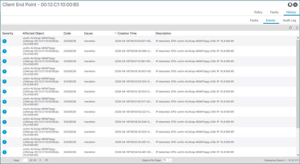

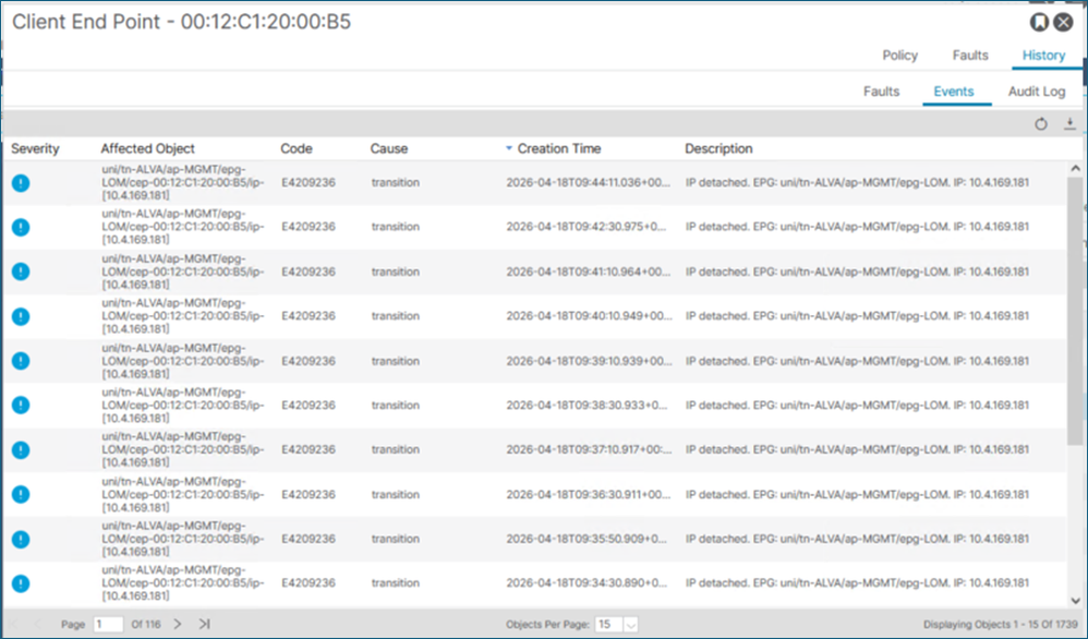

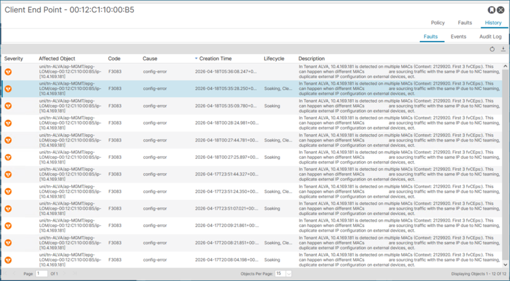

As for the ACI and SK you provided, that makes sense, but we should have alerts on ACI side if an IP changes MAC .
As you see, we have the same MAC for the SG IP:

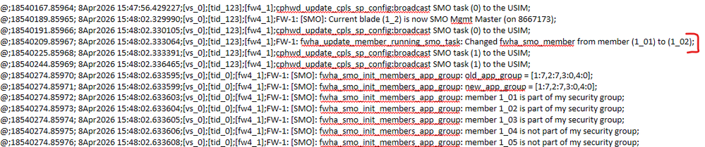

PS: I've run the zdebug on both nodes while checking SIC and getting failures, and I did not get any packets, so during the SIC check SMO was not changing, I guess....
Gennady
Collaborator
If there are no messages in zdebug during the problem replication. then we can rule out SMO flap.
An example of SMO role change is below:

just to clarify for myself, what would cause an SMO change ?
Other than the shut-down/reload of the active one.....
can I trigger that by CLI so I just confirm it ?
Thank you,
Gennady
Collaborator
Good day!
The easy way to trigger SMO role change is by brief shutdown of downlink port from MHO side.
Use "orch_stat" to find logical port number for downlink interface which leads to SMO. Then you can use tor_util on both MHO at the same time (you can try just one MHO at first for the test):
"tor_util set_port_admin_state <logical_port_number> down && sleep 1 && tor_util set_port_admin_state <logical_port_number> up"
Example:
"tor_util set_port_admin_state 65 down && sleep 1 && tor_util set_port_admin_state 65 up"
The command above will disable downlink port for 1 second and then bring it back UP. This results in SMO role change from 1_01 to 1_02 for ~35 seconds and then it will go back from 1_02 to 1_01. You will see both events in zdebug. The zdebug command should be executed on 1_02 because you will break SSH to 1_01.

  • Option 2: As of Cisco version 5.2(1g), Endpoint Dataplane Learning can now be configured at the EPG level (per host). To resolve the behavior, simply disable Endpoint Dataplane Learning for the relevant Check Point Cluster / Maestro IP Address(es). The new configuration options are explained in this Cisco documentation.
So, we had checked our DC ACI and we could confirm what the SK states.
and
Based on those information’s we’re seeing in the Faults/Events I was able to confirm that the management issue could be cause by "Dataplane Endpoint Learning".
As this confirms that we indeed had 2 MAC’s pointing to the same IP address – 10.4.169.181 from the 0012.C110.00B5 and 0012.C120.00B5
and
To confirm those, we have also tested by temporary moving Management Ports outside ACI and as soon as DC guys helped us with the connections move, we could validate SIC for 5 - 7 times. Previously we could not get 3 out of 5 validations.
As we can’t stay with the Management outside of ACI, we discussed with DC ACI responsible colleagues to disable the “IP Data-plane Learning” on specific IP’s and confirm if that fixes our problem or not. Just few minutes after we had set the specific IP's to not do “IP Data-plane Learning”, we could validate the the SIC communication, same way we did while outside ACI.
In conclusion, if you have in your DataCenters ACI implemented, or wherever you install Maestro, make sure that the Security Group Management is either outside ACI - if that is possible - but if you don't, then add the Management IP's specifically and disable “IP Data-plane Learning” !!!!
Confusing part was that we would expect to see Alerts on ACI, like any other MAC or IP flapping but that was not the case. On Maestro Security Group, it seems that even there is one SG appliance selected as "primary" for Management, the traffic shows with MAC from each node in certain cases.
[Expert@ALVA-SGFW01-s01-01:0]# ifconfig | grep 00:12
wrp0 Link encap:Ethernet HWaddr 00:12:C1:10:00:B4
[Expert@ALVA-SGFW01-s01-02:0]# ifconfig | grep 00:12
wrp0 Link encap:Ethernet HWaddr 00:12:C1:20:00:B4
[Expert@ALVA-SGFW01-s01-03:0]# ifconfig | grep 00:12
wrp0 Link encap:Ethernet HWaddr 00:12:C1:30:00:B4
[Expert@ALVA-SGFW01-s01-03:0]# asg stat -i tasks
| Task (Task ID) | Site1 |
| SMO (0) | 1 |
| General (1) | 1 |
| LACP (2) | 1 |
| CH Monitor (3) | 1 |
| DR Manager (4) | 1 |
| UIPC (5) | 1 |
| Alert (6) | 1 |
| SDWAN (7) | 1 |
